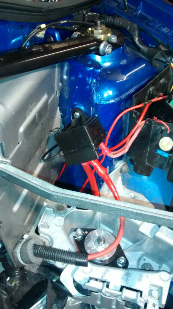

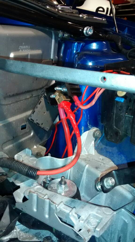

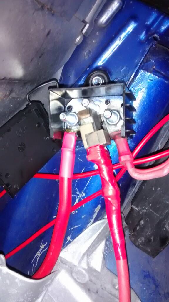

Here's how I did mine, connector block in original battery location, new battery behind passenger seat (although I need to relocate it further back as the passenger seat is to far forward)...
  Clio 172 (CUP)
BTW, I went with a three way block purely due to the size of existing mega fuse and cable termination, as I didn't want to snip them off. It just squeezes in on an angle. I can dig out my parts supplier but they're fairly common components.

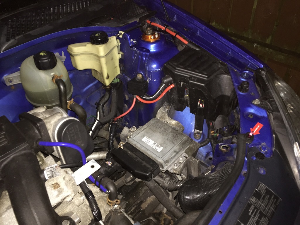

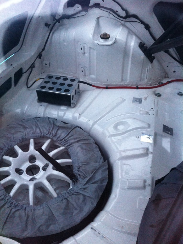

Started with the relocation this evening. I intended to put the pc680 behind the passenger seat but my mark fish motorsport seat frames won't facilitate that so its now going in the spare wheel well. Will be earthing off one of the old isofix/seat bolts.

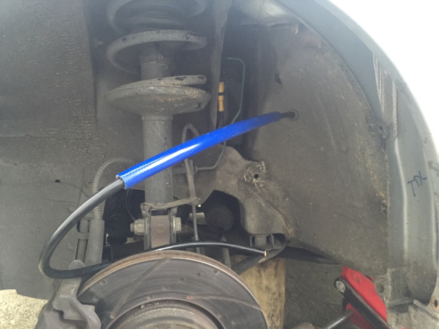

Ran my cable from the boot under the door sill plastics. New hole and grommet through the passenger well (ft wheel and arch plastics removed) up under the washer tank (wipers removed) and into the fuse area. 25mm2 automotive cable.

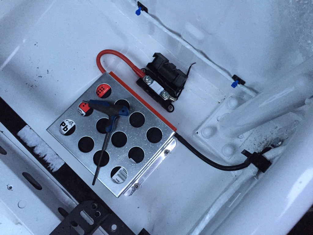

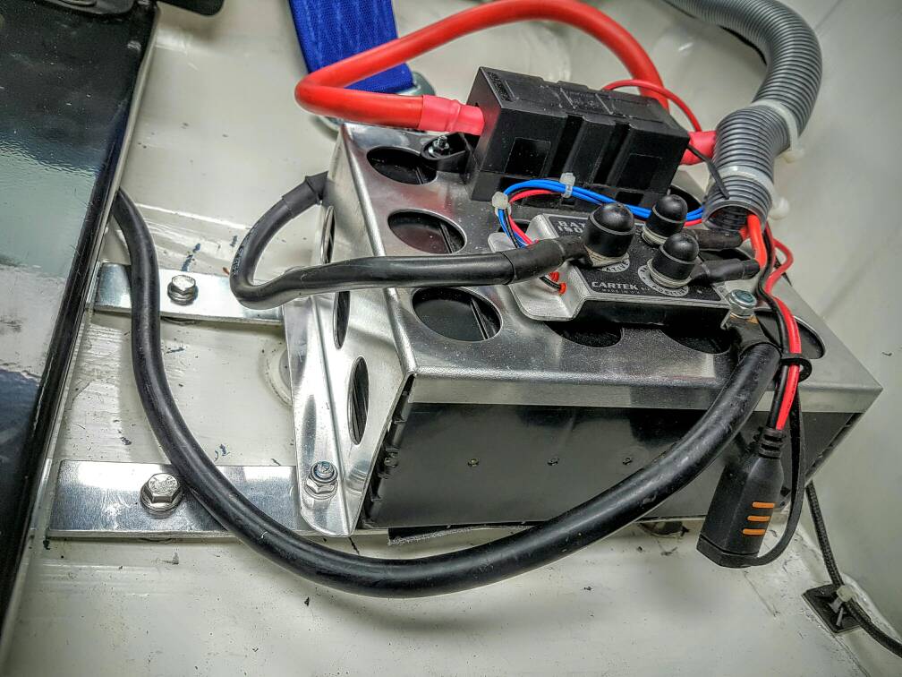

Just to follow up on my install, might be useful to someone reading this in the future.
After going with a lower seat sub-frame on the passenger side, and with a fire extinguisher already installed closely in front of that seat, the position of the seat ended up too upright and uncomfortable. I couldn't move or lean it any further back without it hitting the battery cage. So with a couple of strips of alu I managed to gain a couple more nches and without having to drill more holes into the floor pan too. It also makes the battery easier to unbolt and remove if needed (as its bolted to the alu strips which are in turn bolted to the floor pan). This gave me enough space to get the fixed seat into a better position and angle.

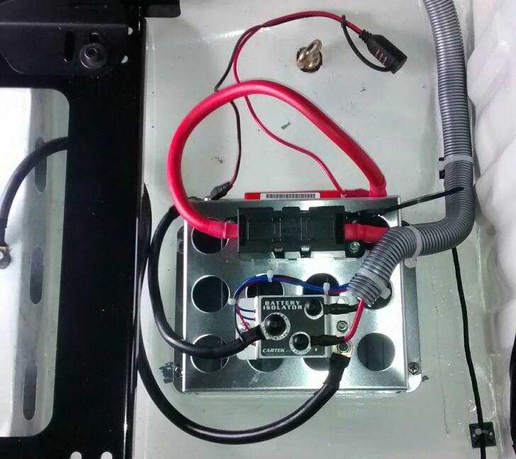

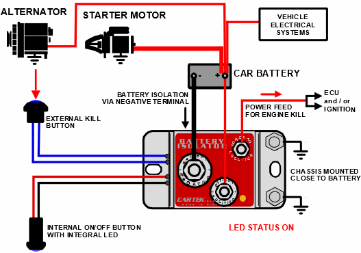

Ah I see. Is it worth having something like that? Relocated mine a while ago and when its standing for a few weeks I tend to just disconnect the negative.
  Clio 172 (CUP)
This is just an electronic version of what's needed to meet MSA regs (mechanical switch being the cheaper alternative), but it is useful to trigger it when I leave the car stored for some time. I still have to top up the battery on the charger/conditioner over longer periods though, the electronic isolators do still consume a v.small but constant trickle of current when in the triggered state, but these disconnect both +ve and -ve when doing so.
http://www.cartekmotorsport.com/battery_isolators.html
