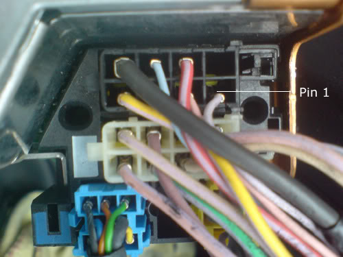

Looks like this. the thin lead is the 12v supply in.

its just an adaptor i think. its hardwired to the HU, and about 2inches long and the aerial connects into it. ive just wacked out the installation manual and there is a wire (which is shows as if its in the car's ISO) with a blue and white sheath saying 'to the remote lead of other equipment of power aerial if any'.....hmmmm will the clio one be this colour?

Thats the one, is it connected in the Clios block connector ?
