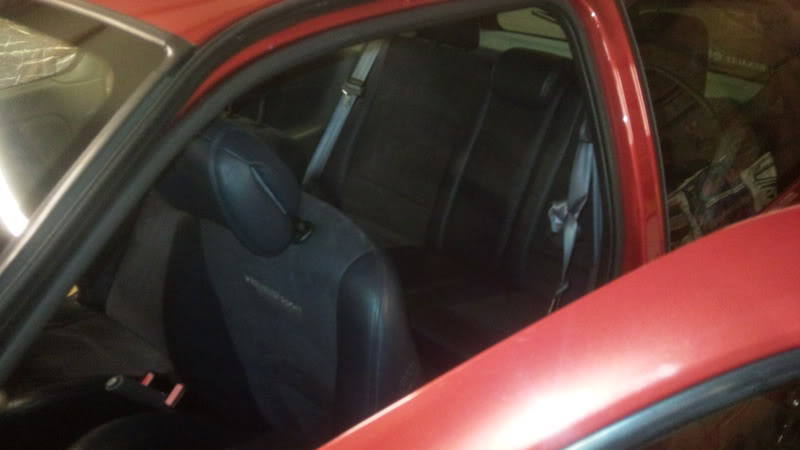

in an effort to get this a little more "everyday car" we had a drive down to hatfield to collect a full interior (leather and alcan)
so these got took out:
and a return to renault lovelyness!
a few suprises!!..
the rear cards that came with the car had some HUGE alpine 2ways strapped in so i dremel`d the new 3/4`s so they fitted nicely and wanged them in
the new 3/4 cards from Hatfield had some E-drive? alpine 2ways in there so they have migrated into the front doors
the bird did a good job of stripping the door cards off! she might even have a talent for this spanner lark!!

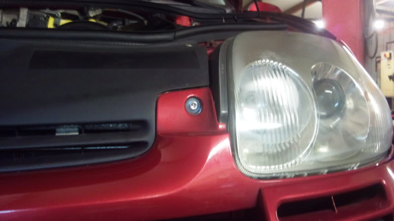

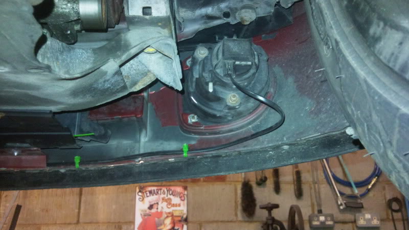

had a look underneath the ol girl at the weekend and found out why the bumper lights seemed a bit lacklustre in working..
theres nowt fecking connected to them!!!!
i had a quick nose around but couldn`t see any stray wires so now i`m confuzzled!!
should these fire up with the fogs?? or are they wired in to the main headlights??
am i not looking hard enough for the wires or have they been "reworked" to get the HIDs working on the main headlights???
any thoughts????

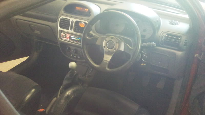

stereo:
managed to get the "connect2" box fitted in and got the stalk working the headunit but after 5 or 6 failed attempts to get the player and all the wires in the hole i got angry and broke out the dremel in an attempt to get a bit more room for all the wires..
out came this!:
the wires were tucked underneath the unit and bobs ya uncle:

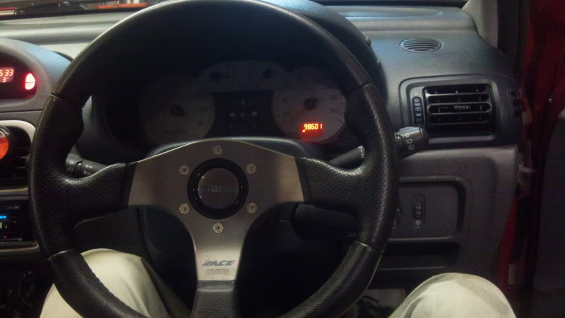

i then undid the steering wheel and banged a resistor in the airbag connector and were now running with no SERVICE light!!!
i also junked the centre trim of the MOMO wheel and replaced the bolts with some countersink ones.. oddly it makes the wheel look slightly bigger.. to me anyhow!

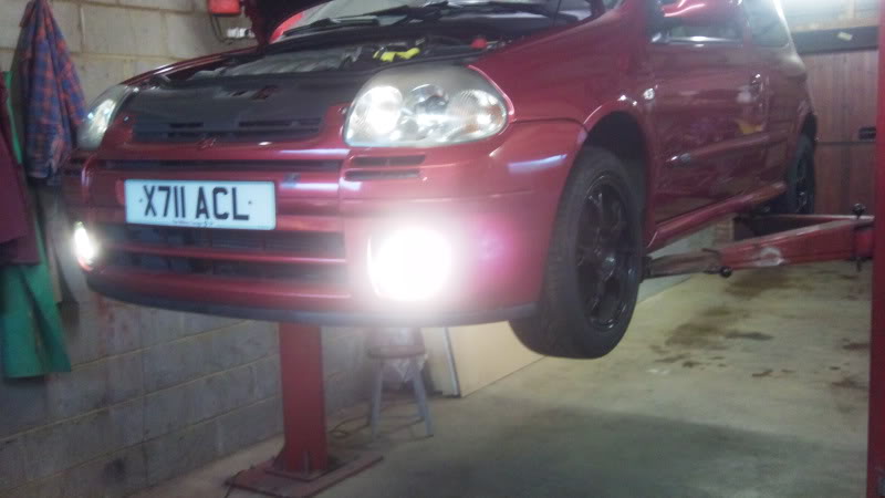

managed to wangle some twin core wire, a waterproof double connector and some adhesive lined heatshrink from work then stopped off at local motor factors and grabbed a couple of bulbs for the fogs!!

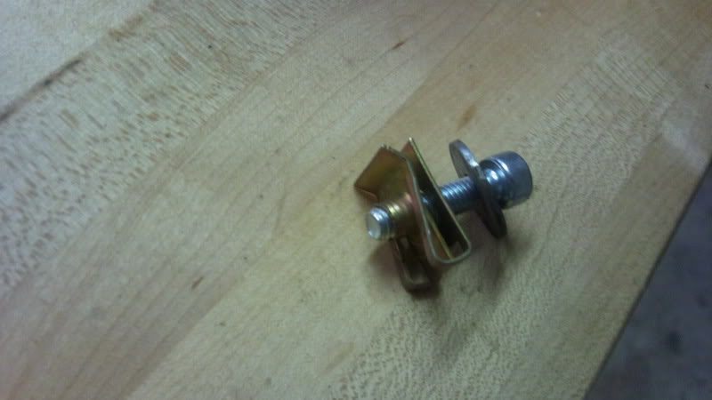

the bumper was took of and whilst doing that i noticed a bolt was missing for the trim piece under the headlights, after trying to wind a bolt in for 5 minutes i noticed the captive nut behind it had broke off!! "je suis une ****" as they say in dieppe..
no big issue though as i had a handful of these useful threaded clips:
2 new bolts and washers and tha was done:
wrestled the bumper off and got busy making up a piece of loom to connect them up to the 2 feed wires, decided to hardwire into the lights (rather than try to find some renault connectors) clip the loom all up to the bumper and then put a new connector in behind the passenger headlight..
Apologies to Matt (TDF) it wasn`t raychem lol but i DID remember to put a smear of silicone sealer either side of the wire where it goes into the light to prevent and moisture gettin in!!!
and then like all true godly beings i uttered the immortal words..
LET THERE BE LIGHT!
after 10 seconds nothing was on fire or smelling so it was declared a sucesss!!!!!

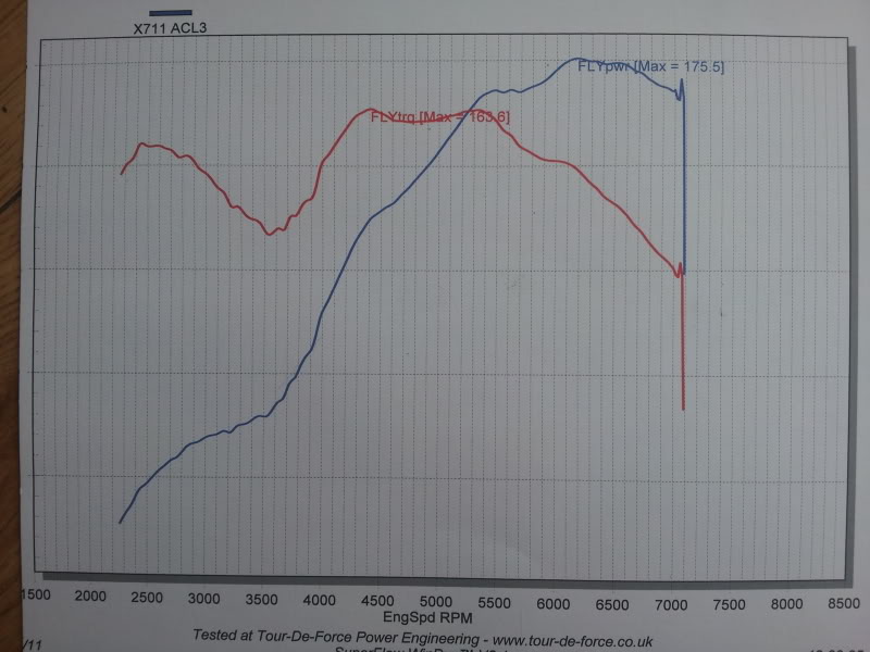

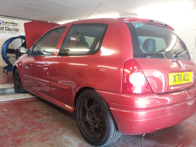

another little update.... managed to get over to TrackGroup for a RR bash...
took the opportunity to strap the birds motor down and see what was happening.....
the engine rocks too much for my liking so may well look at some stiffer mounts... other than that... she`s a strong `un!!!

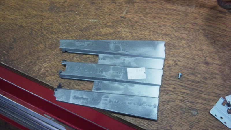

the boot refused to unlock the other day, and a quick call to Lord Faulks @ TDF confirmed my fears - "yeah they do that" was his reply...
so..
seats down, torch in my teeth, torx driver in hand we had the trim off and the boot open...
when i pressed the keyfob the solenoid thing defintaly sounded like it wanted to do something, after a few minutes of poking i determined that to "lock" and "unlock" the boot the solenoid should fire the mechanism in and out, all mine was doing was clicking...
i removed the white coloured solenoid/motor assembly and was comfronted wiith a big black cog and a tiny brass cog,
at this point i made an error...
i pressed the key fob and in and instant the black cog fired off and disappeared under the car... ****!!
after retreiving the bits it became clear the black cog has a spiral groove in the underside and as it turns the mechanism moves in and out, a cotton bud with white spirits and a dollop of plastic friendly grease and it was back together and working again...
happy days!!!

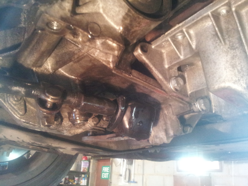

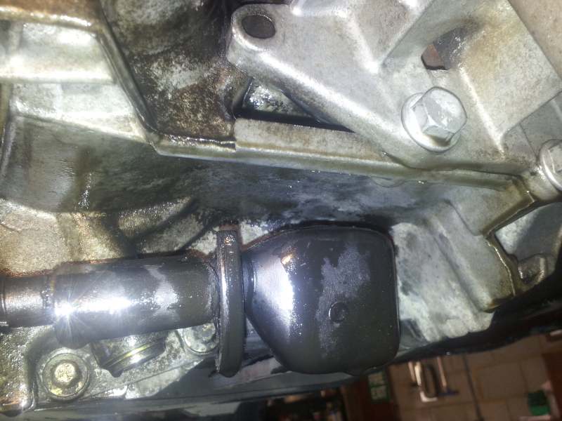

noticed a few spots of oil this past week on the driveway, had a look underneath and yup, oil everywhere.. so i cleaned it all off with brake+clutch cleaner and used her for a bit in an effort to find out where it was coming from....
today i noticed anything over "spirited" acceleration caused massive clutch slip, and when i got underneath it was dripping like a p**n star after a bukkake event...
the sump still looks dry but its pouring out from inside the bellhousing, so either that bit of sump gasket or crank seal...
so, new clutch kit, new sump gasket, new crank seal, new flywheel bolts, new oil, new filter....... basically a b*****d expensive bill!!!
hoping TDF will have time to fit it in, if not M+W in wisbech will get the job...
Ouch mate thats not good :( Hope you get it sorted! I've noticed some oil mist around the seal on my new engine but decided against changing it, i'm hoping my decision is not going to bite me on the arse!

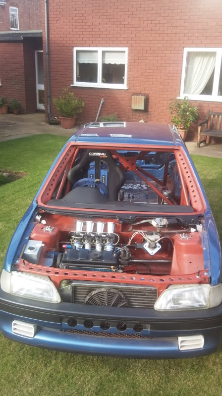

Haha the rattlebox is progressing, engine loom is done i beleive, there was an issue with the injectors (gsxr1000 items) as they dont use a std plug, luckily i found the original suzuki loom so reused the factory connectors..
Tbh its all been a bit back of my mind these past months, my sons 7weeks old now so its been chaos here for a good 3or 4 months gettin things ready and then gettin in a routine with him...
Will press on with it next year, bought a few bits that sit here but thats all...
Likely culprit appears to be the gearbox input shaft seal...
Whether that has gone on its own or as a result of the input bearing going causing excessive stress on the seal.. Who knows! Either way it was fooked so new box on today along with new clutch and all seems good..
No clutch slip and an indicated 145 on the way home.. That'll do!!
