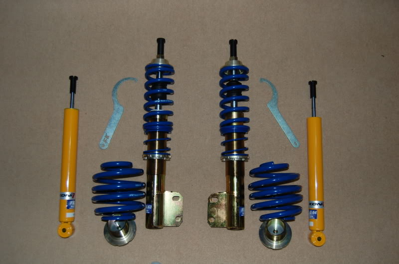

hi. so i baught some fk jonigsport coilovers abiout a month or so ago and fitted them all correctly. but now they have bedded in i can finally sort the ride height out and put the car on its dish!

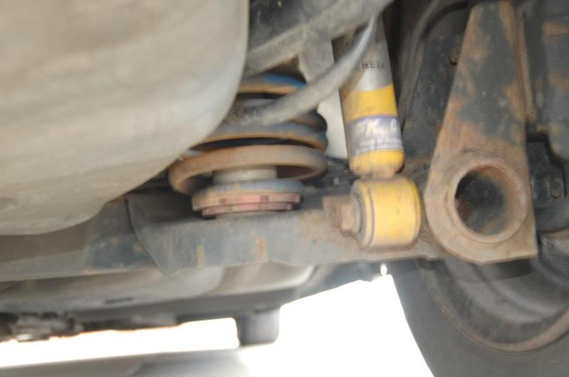

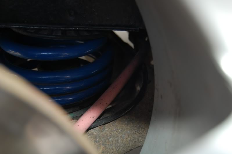

does yours look this this?
most certainley does look like that, all correct parts came, fitted, bedded in, try to slam it and doesnt have any of it.

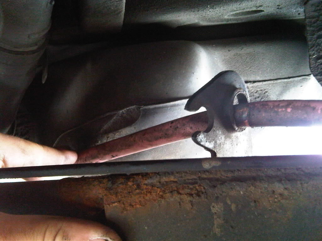

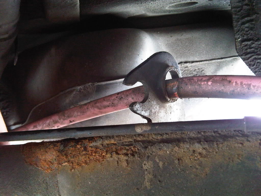

Thanks for the pics karl, much appriciated. Now i know my cable is in the right place in the braket ''the big hole''. it seems to be running through the bottom of the car correctly but wrongly over the axel causing the following..

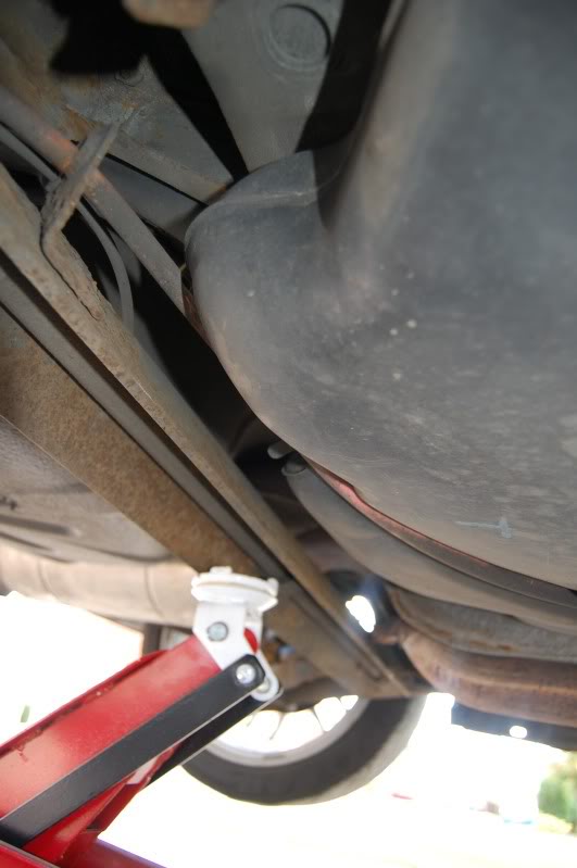

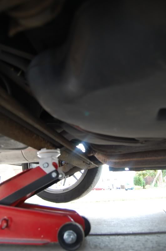

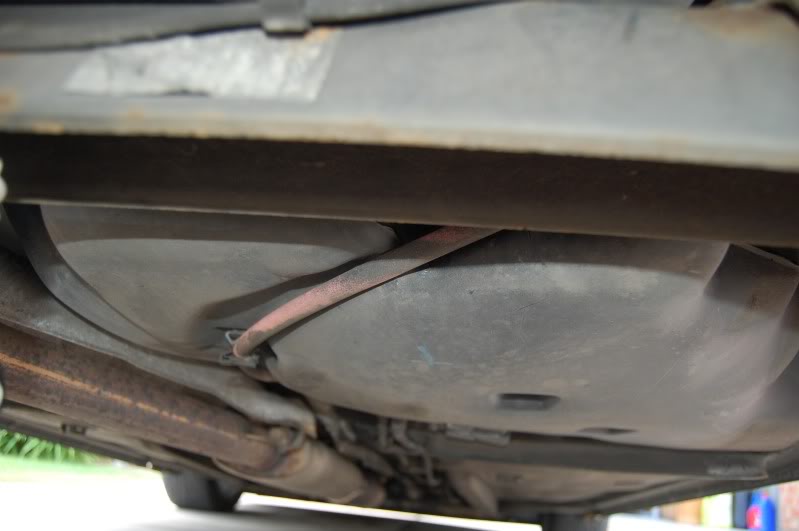

Just been under the car and had another snoop about, after removing the spring i seen this! the handbrake cable in the pink piping is runing over the rear axel in a way that its managed to get itself trapped and pinned betwen the axel and the fuel tank, causing the rear axel to jam up and not allowing itself to go any lower...
how can i route the cable/piping corectly now, so i do not foul the fuel tank as this i think is overall problem..

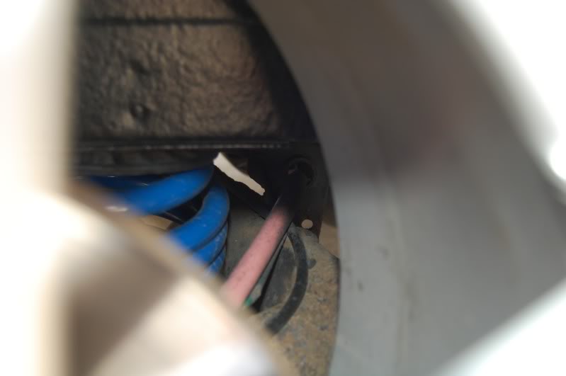

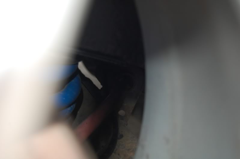

right, from what i now know, ive disconnected the handbrake cable and pulled it out from through the hole in the bracket. now its been re-attached it to the C shaped clip on the side of bracket as seen in picture pulling it further away from the axel so it runs more parrallel with the axel and away from the fuel tank.
its nicely wedged in and a big tie wrap around through the hole and around piping just to secure it and for piece of mind. going to put the spring back in now and see if goes low now...:star:

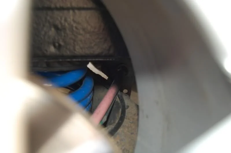

springs in place, fgdfgfdg fail!! atleast the handbrake pipe wont rub anymore and get trapped up.
