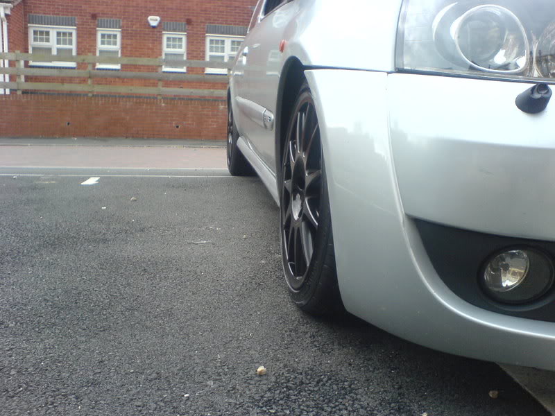

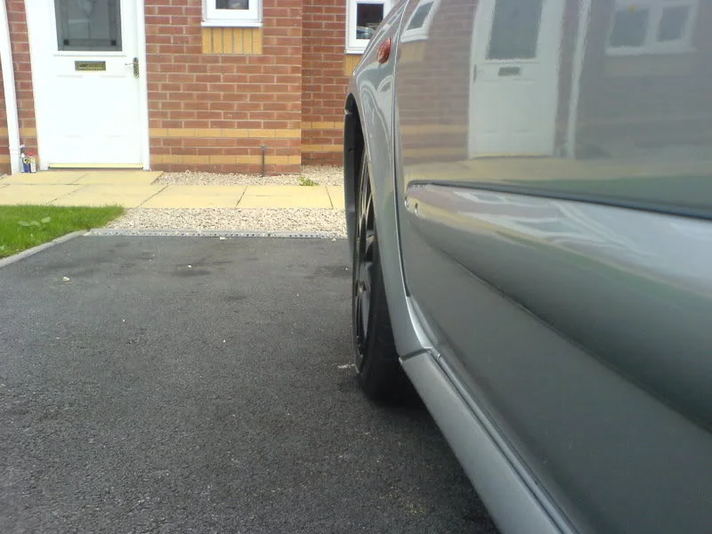

Now:- [actually I think I have put less neg camber on since these pics:-]
Oh and beware - when you adjust your camber you will prob need to do your tracking. My steering wheel was out for a while - now as straight as a die.
