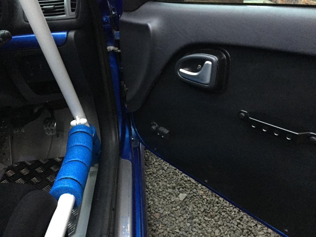

I removed the passenger side switch, fitted the drivers in the card here......

  Hi comp phase 1
Ph1 switches will fit flush and clip in on door cards with the right size cut out. I've done it on mine, just used a dremel and disc to cut a rectangle and slotted the switch straight into it. I've had them like this for a couple of years with no problems.
KitsonRis
@green do you have a picture of this? As if you say this will work then I would rather this than extend the loom. Do you mean clip in using the little tabs on the switches?
@MarkX your door cards look nice, good little custom job there.

Thanks @green that is exactly what I wanted to see. This and MarkX's picture have helped. I will go buy a dremel and do this! Unfortunately it won't be until the new year as the car is at my dads and I only go there at weekends. I really need to get a house with a drive way.
