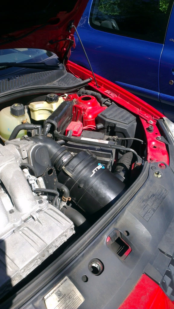

Here's a picture of BigDaves fitted, nothing really holds it in place just wedged in there

Cheers for that mate, looks like the standard induction hose is shorter than thew Samco, so I will have to cut that down.Looking at that pic, I cant see any reducer between the airbox and his CAF. Which suggests its just sat in there with about an inch gap for dirt and crap to get in ?

Leave the CAF off. It is better without it on. There was a big discussion about this in another thread I can't find. I was thinking the same when I was fitting mine but all I did was rest the existing feed in the recess in the airbox. You could just leave it hanging out, TBH.
Something about the air getting up through that CAF is very restrictive and actually reduces the cold air getting through. Leaving it open forces more air in and because it's facing away from the generating heat it's fine. It also sounds better ;)

Really? Never thought anyone would suggest that ! I am willing to take your word for it though. Such a shame to cut the Samco though, just impossible for the air box to fit in the bay though unless I do :(

Scutch cheers for that mate - very interesting. I too would have been looking for a larger CAF pipe as on user mentioned. ill just leave it sat in the airboxlooks like ill have to cut the samco by around 20mmcheers again

When I had the Clio, I used the standard bend on mine, but on my previous 182 I used a blue samco to a BMC CDA. It did need cut down to suit it. As for the V6 airbox, yeah it was just left to hang loose although because everything was so tight in there, it was a pretty neat fit.
