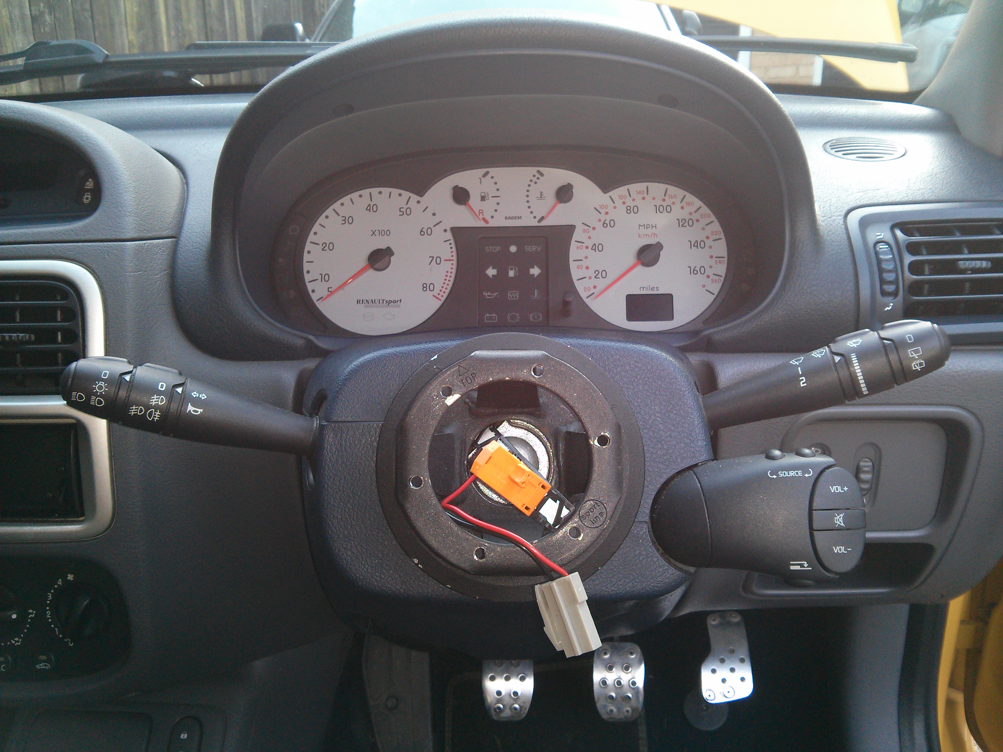

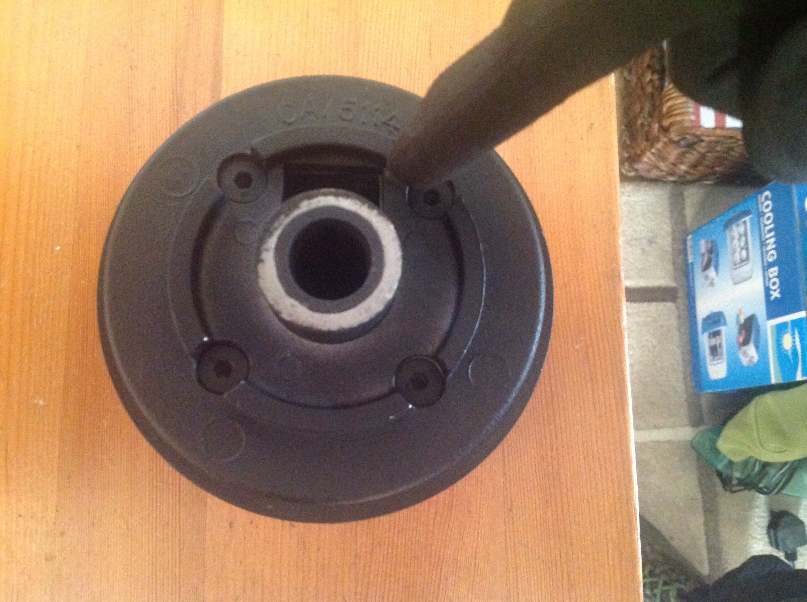

However the boss is causing a headache
The hole which you should pass the wiring through for the airbag and controls on the boss itself is to small..
You can see the area in the picture..there isn't any space behind the hub as you have all the other gubbings.
Is there a different boss or just an obvious fix at all....
Any help is appreciated.
Craig.

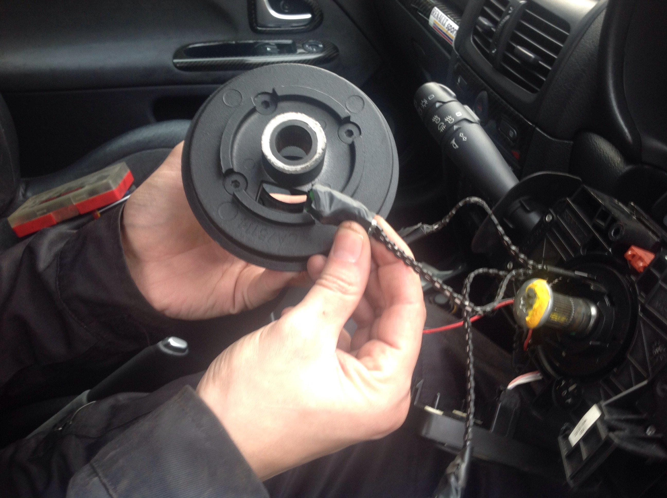

This was mine as I fitted it... it was spacious and hollow so there was no issues what so ever...
Are you sure you've got the right boss !?
Infact .. are you a stage prior to the boss being fitted !?

I'm not sure if it's the correct boss no....
I offered the boss up and need to poke through the cables and the hole is smaller than the electrical connectors..

I'd like to keep the loomin tact.
However the loom looks like it un clips from the harness just don't want to force it..

Is it an OMP boss?
Some people report the hole too small to fit the connectors through, although it's usually the cruise one that causes issues. I think most end up returning and paying the extra fiver for a Momo.

looks like an omp boss is it not? I cant help you with the cruise connector as i fitted mine to a 172 cup but the airbag connectors fit through easy if you flip the clip on the connector up first before trying to pass it through
