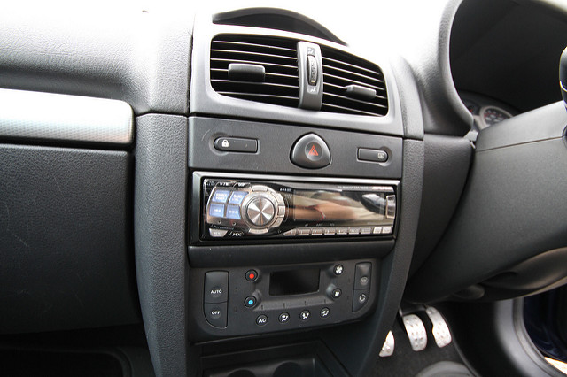

I apprecaite what you're saying about the OEM look of the HU. I changed mine for an Alpine with "Blackout" and a connection tothe dash-top display.
I find I don't really look at the headunit so it doesn't bother me

I understand this stands out a little from the standard one, but TBH the standard ones look awful anyway. Does this really look out of place ?
  Listerine & Poledo
aftermarket stuff will always look out of place, but that's for any car.
Still, a subtle Alpine unit (or an old nakamichi, if you can get one) isn't going to ruin your console as much as, for instance, a Sony XPLOP!!!!!! or whatever they're called.
