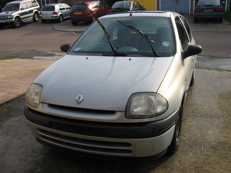

Right well the PC turned up all my bits turned up and my mums neglected Clio 1.2 RT sat there beggin for a clean, so i did.

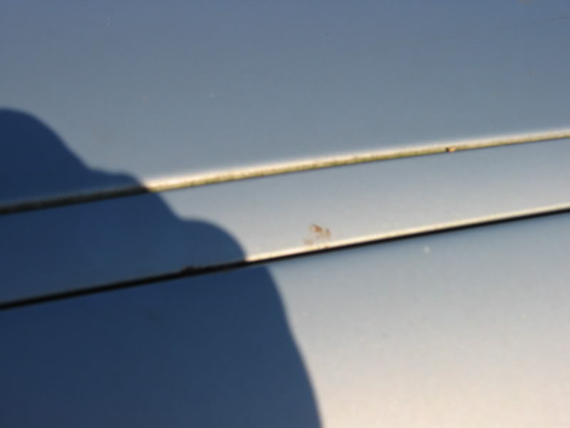

This was in very very bad way, not cleaned for at least 6-8 months, swirly paint & bird poo all over it amoungst moss and cat prints. Its just sat on the drive gets the odd motorway run but mainly just sits and gathers everything it can to sit on the paint! :(
Thats was before i know the pics are not great but hands were cold and also i didnt think about what pics to take so there a little random!

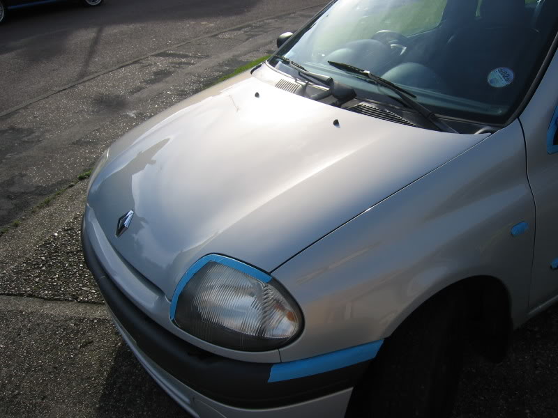

Washed

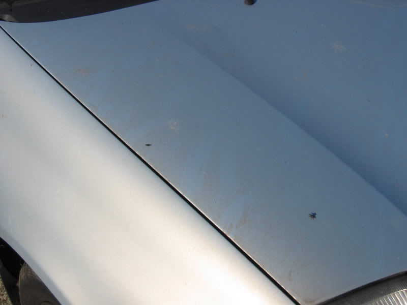

This was after my first PC attempt, i know its not the best but i only used Poorboys SSR2.5 and then SSR1 then just Gold Class wax.

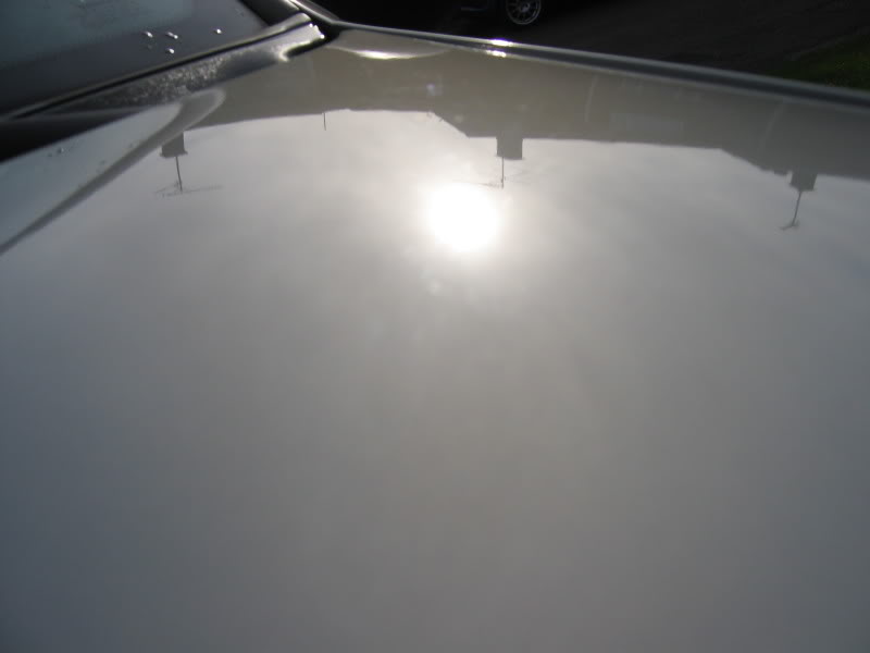

This was after
swirls mostly gone
And my favourite pic, and prob the best panel correction

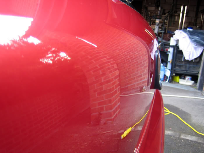

I have no pics after i completely finished with the wax the above on was just after the two polish's - it got dark so you cant see the finished article.
All in all not as good as some on here but i am chuffed with it as my first effort and especialy taking the condition before!

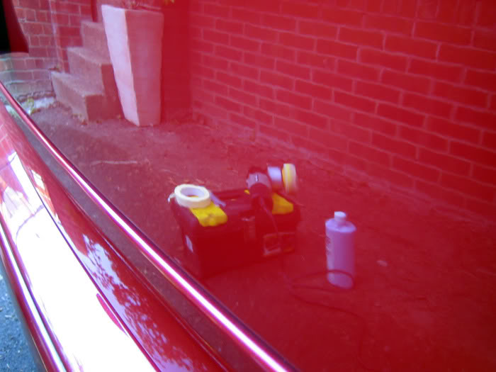

What i used:
Washed with AG shampoo 4-5 times
Clayed using shampoo/water mix and megs clay
Pc'd with SSR 2.5
Pc'd with SSR 1
Wax'd with Megs Gold Class
