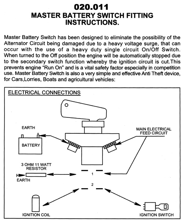

Looking to fit an FIA cut off switch just wondering if there is a guide anywhere.
Think I'll be ok cutting the main feed, but where do people tend to wire in the secondary part of the switch to stop it running off of the alternator?

You need to cut power to the ignition/coil when it's turned off.
Also you need to wire a resistor to ground from the alternator side when the switch is turned off to protect the alternator. Needs to be a high power low ohm resistor like a 3 ohm 11w as pictured.
This diagram should help:-

Cheers, It was where the best place to cut the ignition that I was after.
On the E36 compact I built most people tended to cut the power to the ECU as that effectively achieved the same same thing
