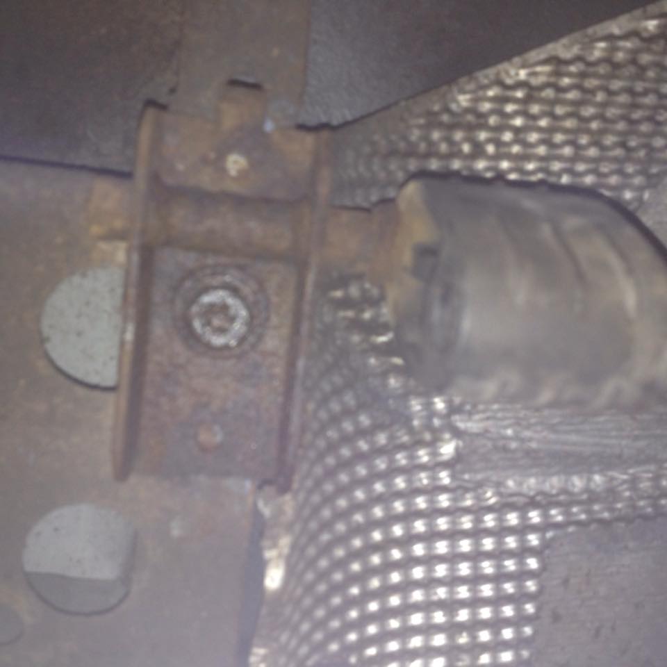

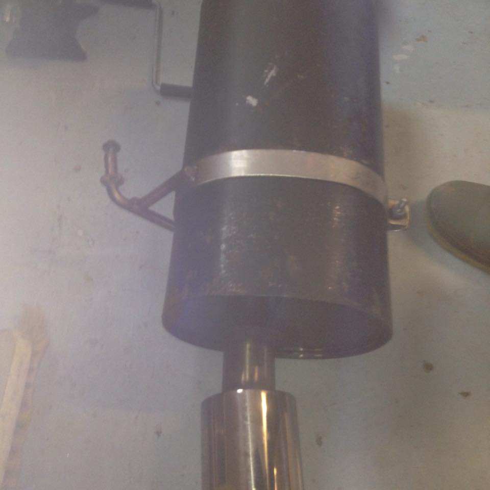

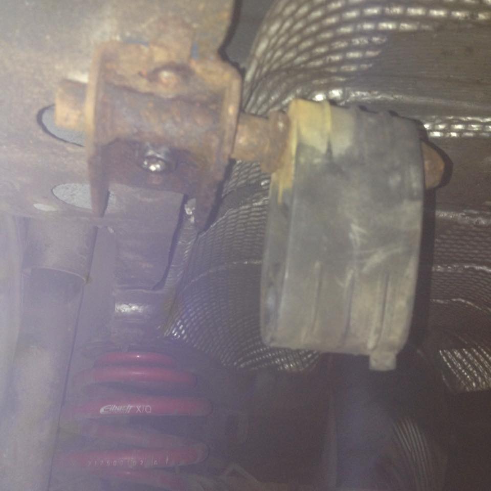

With a lot of swearing the old exhaust came off and I have managed to fit the ktec centre pipe from the cat. However the back box is proving a nightmare, for a start the rear exhaust hanger is different, can this OEM hanger be adjusted to face the other way? If not what hanger do I need? Also I am having a nightmare trying to remove it, the bolt is completely seized i've used all the tools I have available to have a go at it (air line included) but no luck. Any advise for this too? I apologise for the pictures as my iPhone camera is broken, but hopefully you get the idea.

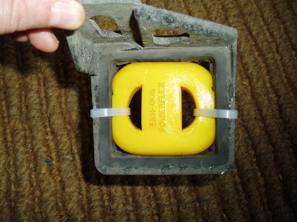

Looks like you may need to swap to an RS hanger which I do have a spare one with a poly bush in, or bend your arm so it is straight.
One of these, but mine is in red.

Are you out of the wet? I don't mind popping over to have a gander. I'm not 100% it will fit, I don't have a gas torch sorry but I do have a big bar.
Do you have a drill and drill bits in case it snaps and some spare bolts?

@1812lsd I'm in a garage, but there is little access to the underside of the car as it's only on axel stands. We do have a drill with various attachments. The bolt is beginning to loose it's shape therefore i'm struggling to get a ratchet or spanner to grip. And as for the bolt, there is a random bolt drawer which is likely to have one to fit. The other issue is I don't have a clamp for attaching the backbox to the centre pipe, this is proving more hassle than it's worth haha!
small world I'm in dorrington and have a blow torch if any good. I changed hangar last week! 1 bolt snapped, and 2 came off. I just drilled new hole instead of drilling out bolt as the hanger can slide.
