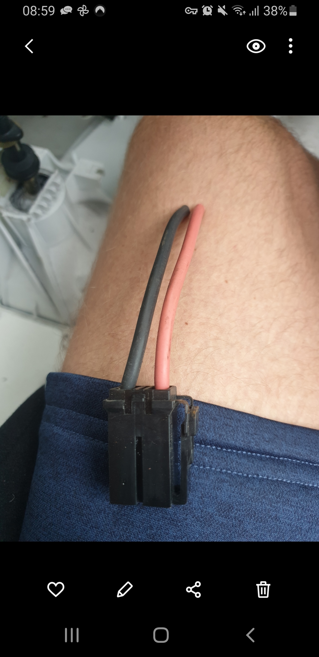

I have an epas kit with this connector, have people rewired and got new spares that fit or just jointed the cable from here ? If so what did you use ?

Join straight onto the cut cables with an uninsulated crimp and cover with dual wall heatshrink. Ideally you want a hydraulic crimper and ferrule to suit, about £30 off ebay.
Id also consider wiring the epas ecu up to the car properly instead of the potentiometer setup, as it does not work right and feels awful.
Oh right is there any info for this on here ?
