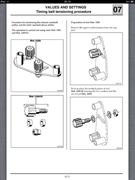

You still need the pulley locking tool which 99% of DIY jobs don't use and then results in a failure.
You need this and this manual to do it correctly
