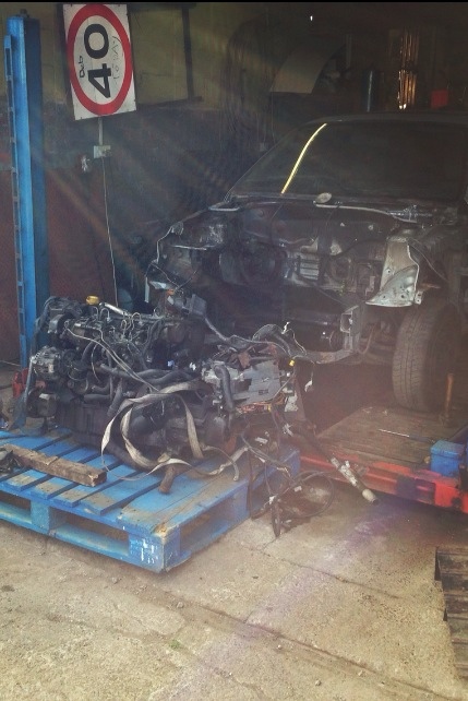

ive split the loom behind the bulkhead by the big connector and left all the wiring and plugs on the engine, i was thinking of just connecting it all back up with donor ECU, UCH and keys
Worst case is it dont work and i put my old ecu in and old injectors
really hope that the dash display difference wont throw this out the window now :(
thanks again
heres where ive left it today
