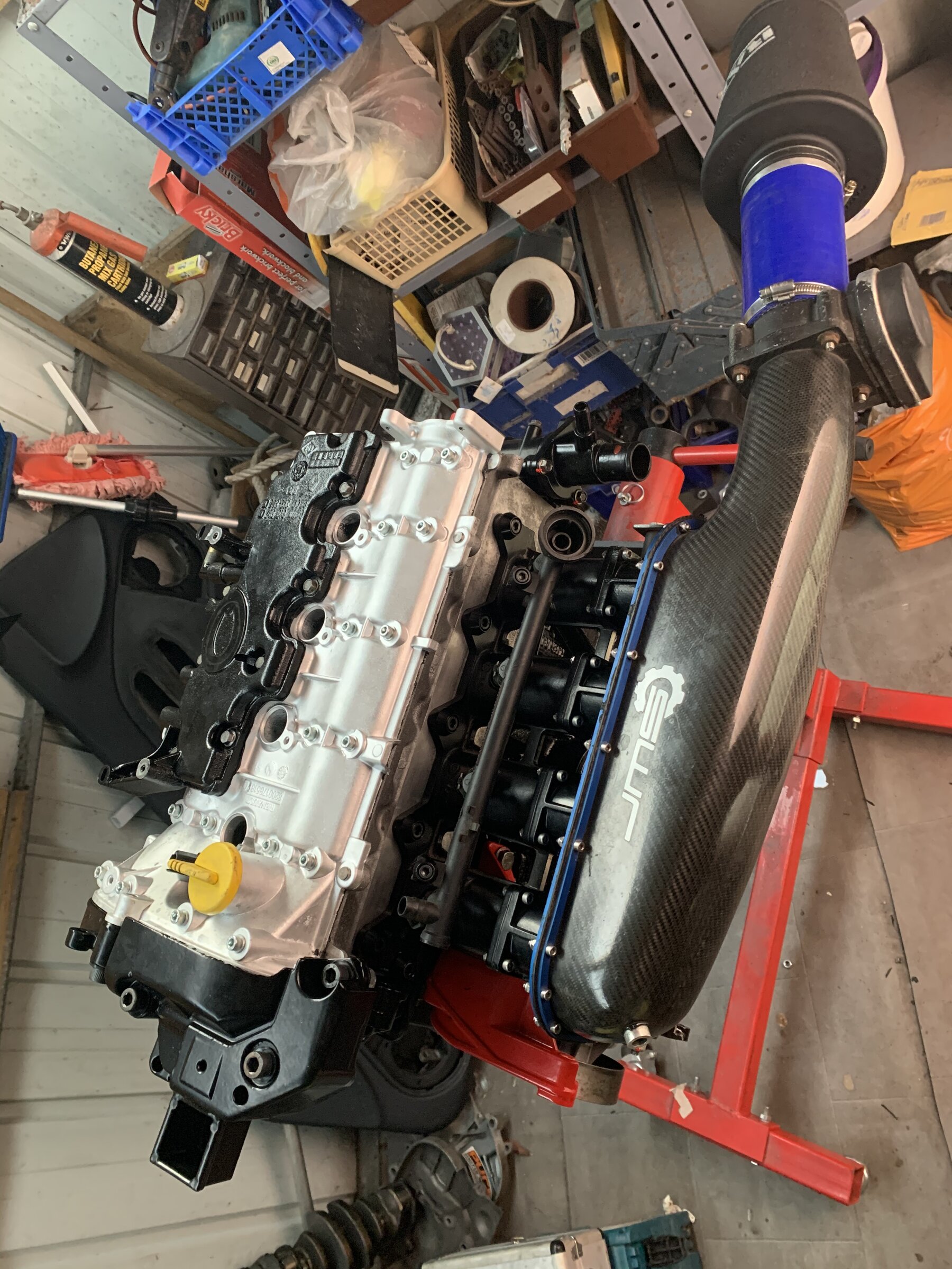

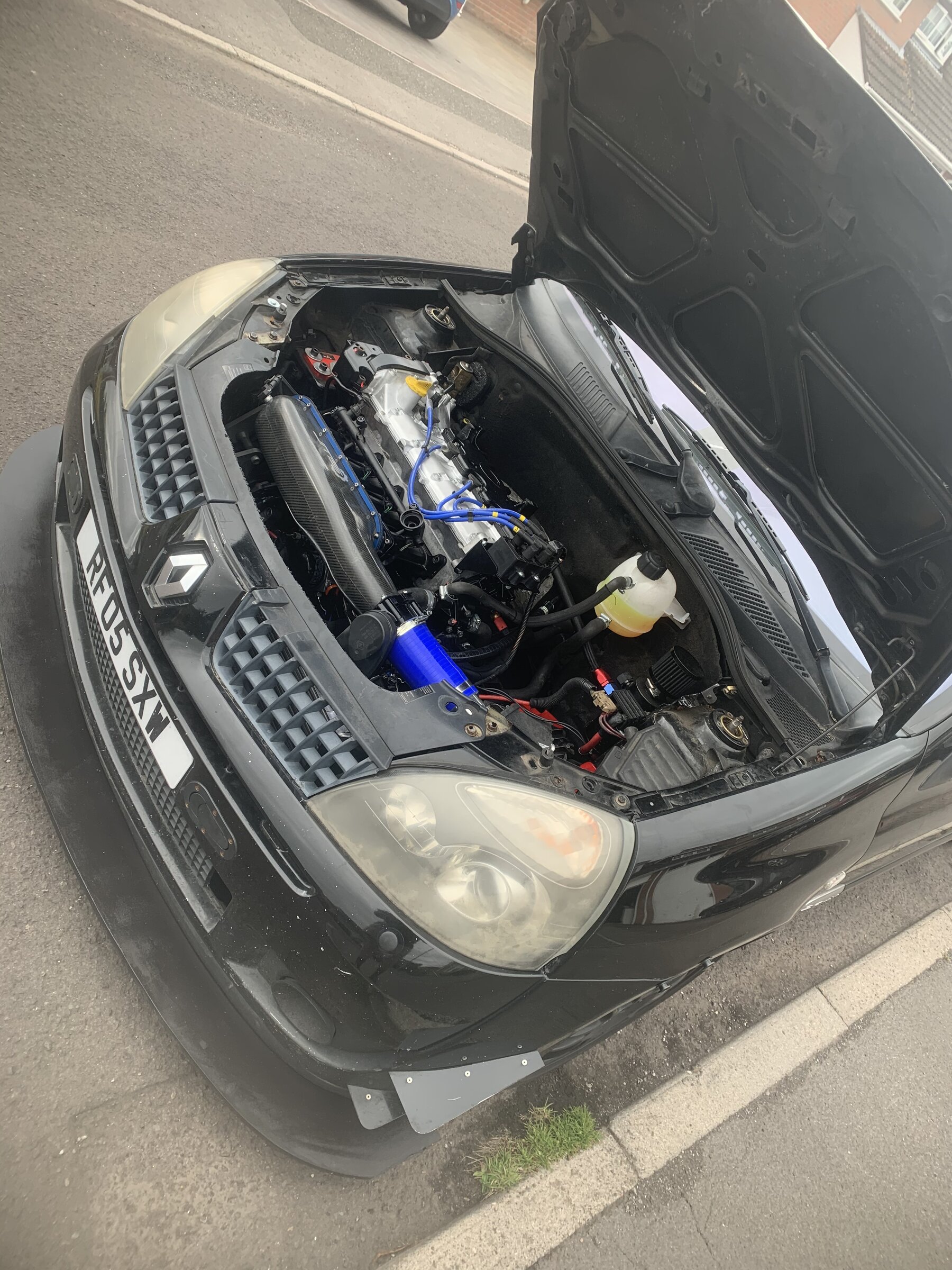

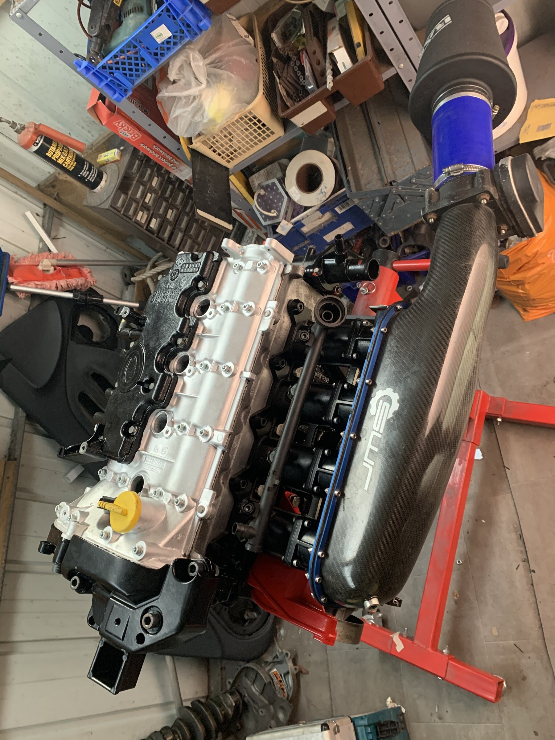

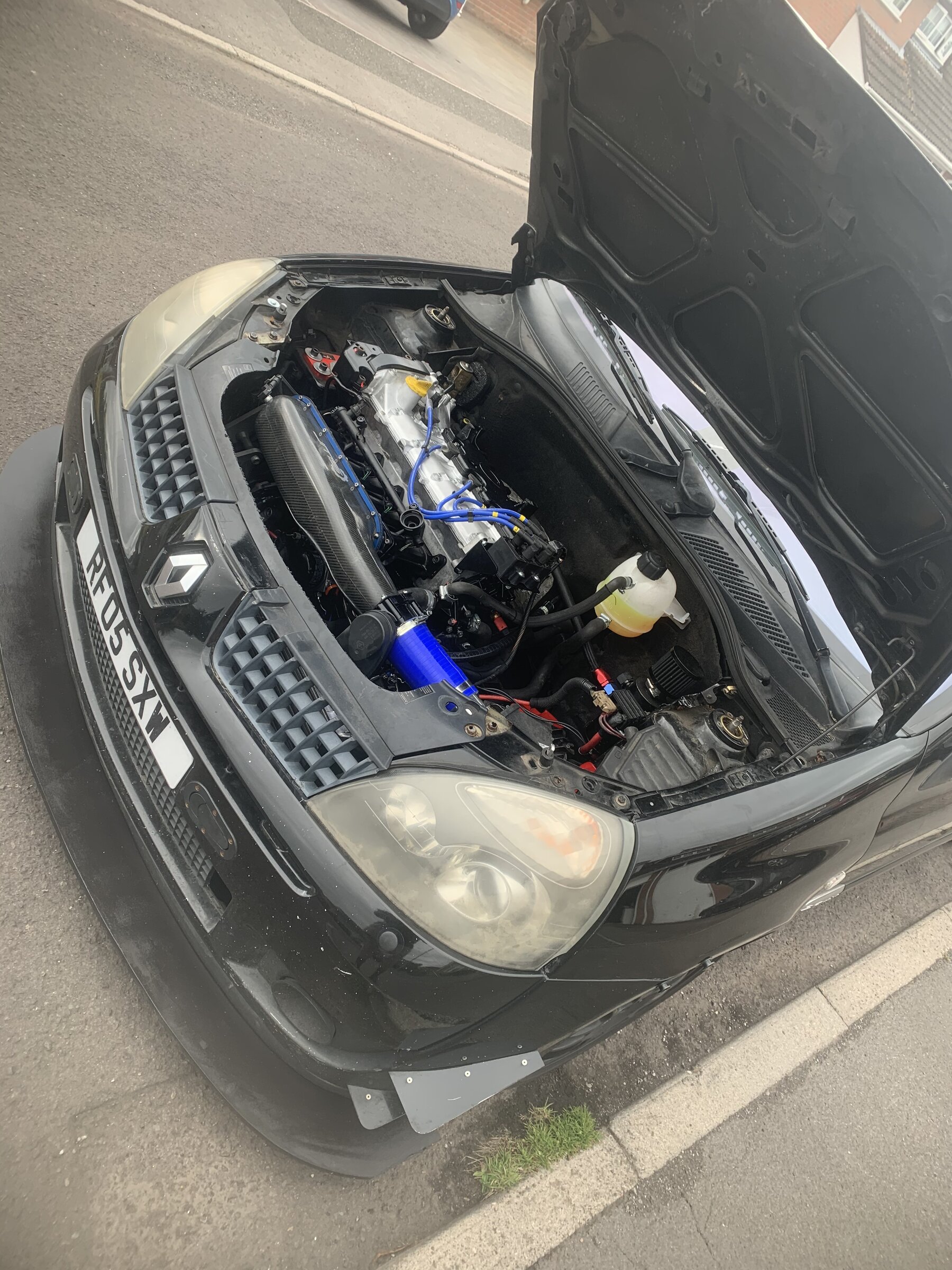

I’ve just literally built a engine with
-Rs2 xtra inlet manifold
(50 mm extra runner length)
-65mm throttle body from ms engineering
-197 pistons
-197 cams
-Cat cam valve springs
-197 injectors
-182 ports polished head
-All new seals and gaskets
-Lightweight ttv flywheel
I’m currently running it in but am going for
Mapping 7th August

Mapping 7th August View attachment 1486773View attachment 1486774
Should make decent power, mine with 182 manifold RS inlets (not matched) 197 injectors ktec induction and group n made 185hp and 170lbft torque
