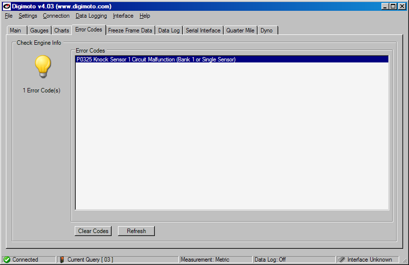

UPDATE
I have had the car plugged into a ODB reader thing, and this is the outcome:
Fault light cleared and it hasn't come back on yet...
