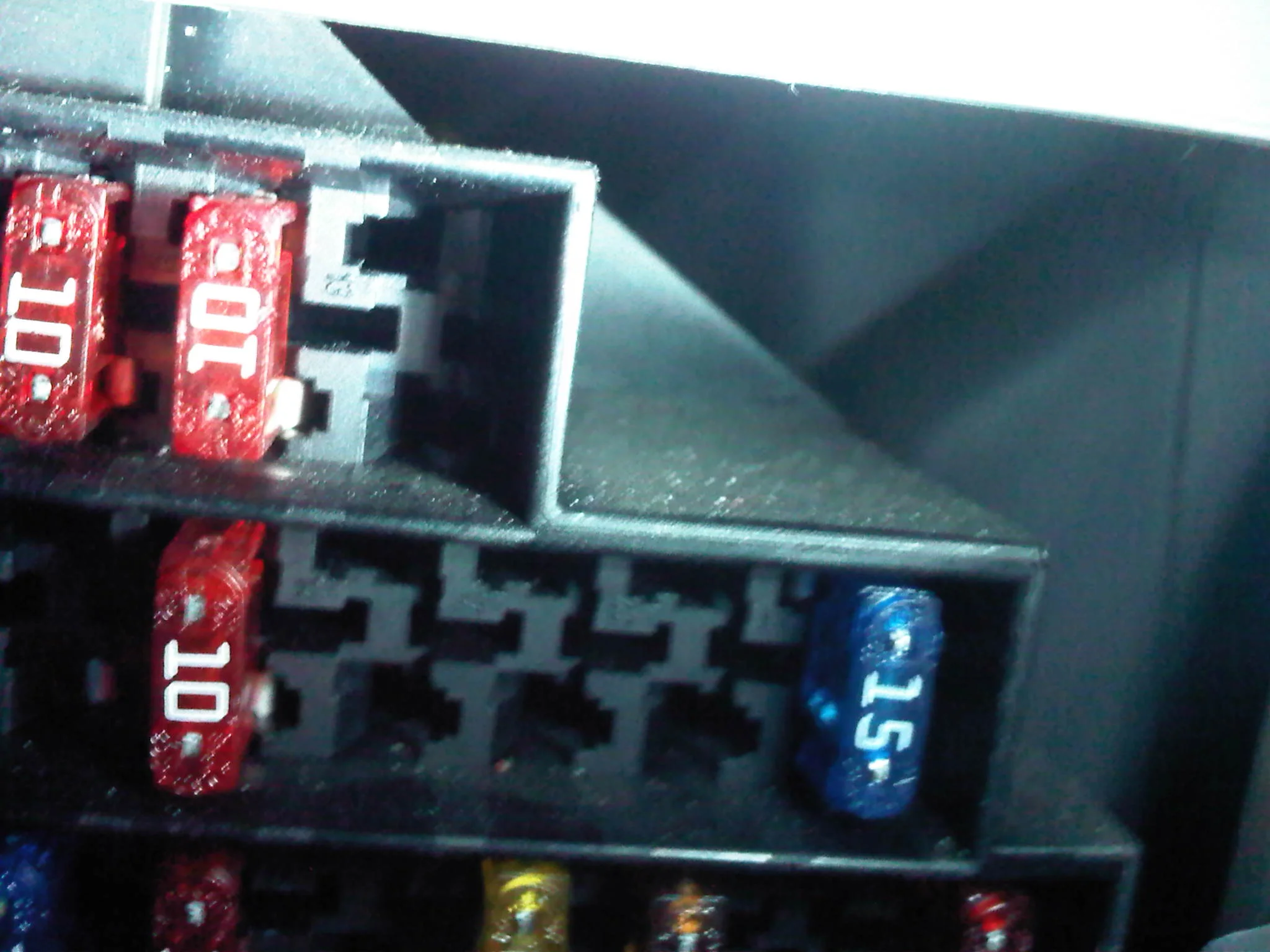

problem i have is the fuse box of my car doesnt have the electrical terminal in the fuse box to allow the fuse to go there :S Thanet-20120829-00053.jpg
is there anyway of being able to run the dual optics and place the fuse inline anywhere? its p*ssing me off!!!
  Jap Box
Most wont have the fuse hole, none of mine have.
If its the same as the sport headlights then you simply split an earth wire I think, theres a guide in the guides section telling you what to do :)
  Rs200
yeah they are just dual optic angel eyes, but i swear even in the guide it has said to add a fuse as to make them MOT worthy :S
yeah because before it was running off one bulb for main and dipped, now your are running 2 seperate bulbs, what the fuse does is keeps the dipped beam on when the main beam is switched on which is needed for MOT pass :)
  Jap Box
Nope its not needed for an MOT pass, mine passed everytime with no problem. My mates focus as standard turns the dipped off when the main comes on so I assume many other cars do too..
Just ignore the fuse part :)
Rob
Why would it? You wouldn't be able to tell when driving.
If you search pretty hard, there's a post explaining how to wire a relay or something so that they both stay on as they should.

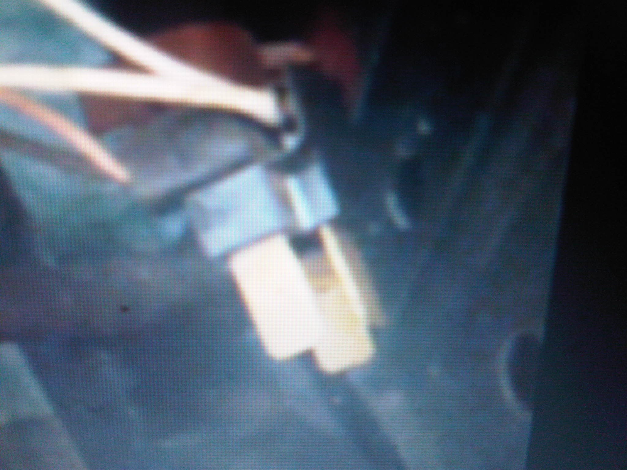

if its not a mandatory i wont bother, was just anoyying me but here is another thing!Thanet-20120829-00050.jpgmy car doesnt have these three pins so i cant actually connect the dipped and main any ideas here? i dont wanna be butchering my electrics
