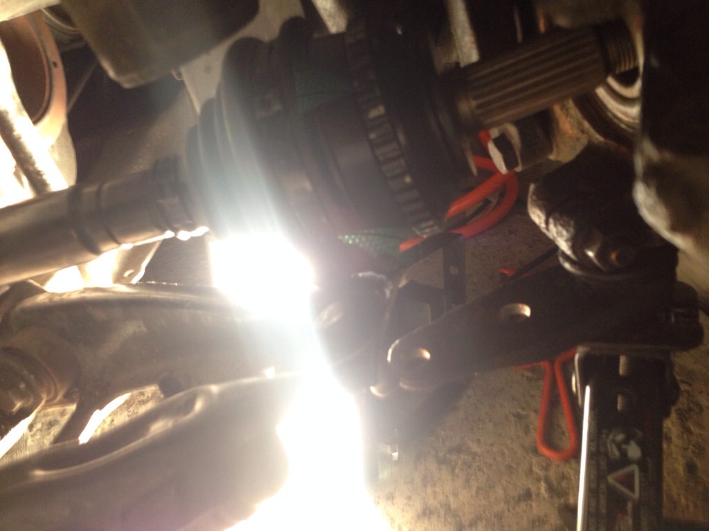

I am in the process of removing the o/s drive shaft and I have come across a problem.
I have undone the hub nut, ball joint nuts, the two nuts that are around the bearing and released the shaft from the hut but it still isn't moving.
Does anyone have any suggestions?
Thanks
  172
Also tried to remove the carrier and can't get that off either.
Am I correct in saying that there are only 3 bolts to remove the carrier.
  Lionel Richie
eh? you only have to undo the hub nut and the 2 lower ball joint bolts, steering full lock, t**t the shaft sticking out the hub, done
  172
Yeah I did that but it won't come out.
Still no luck with it either.

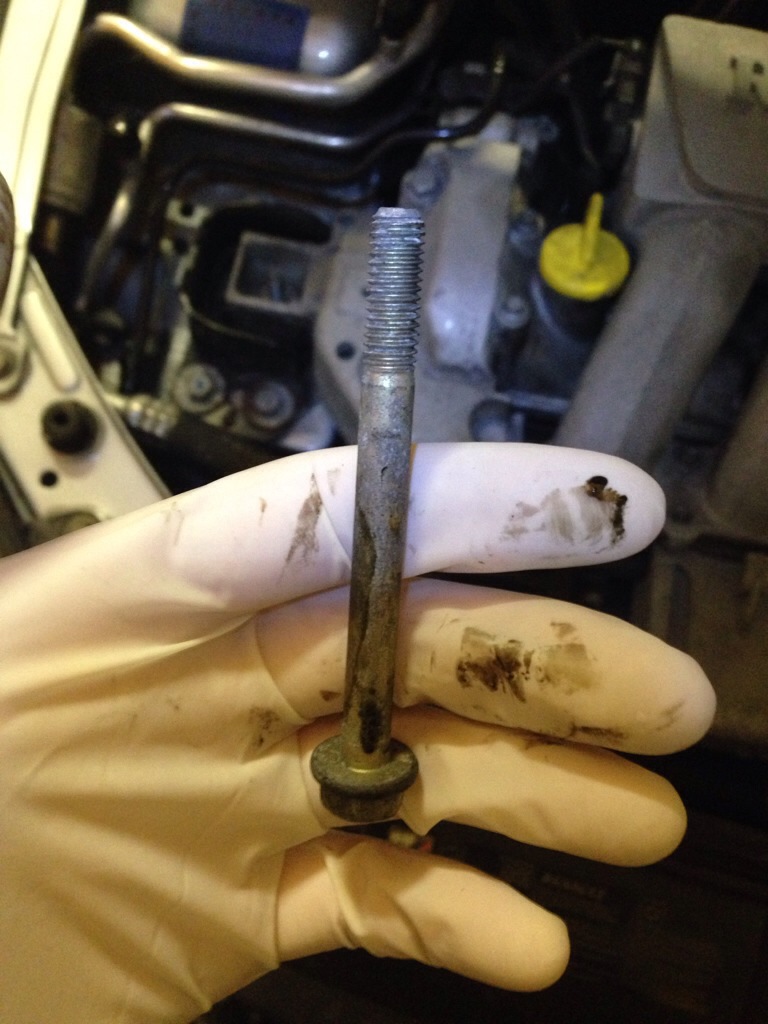

Also found this
Any idea where that is from?

Also still no idea where the rather long bolt has come from......
  172
The long bolt is from the inlet manifold.
Yeh copper slip is fine.
