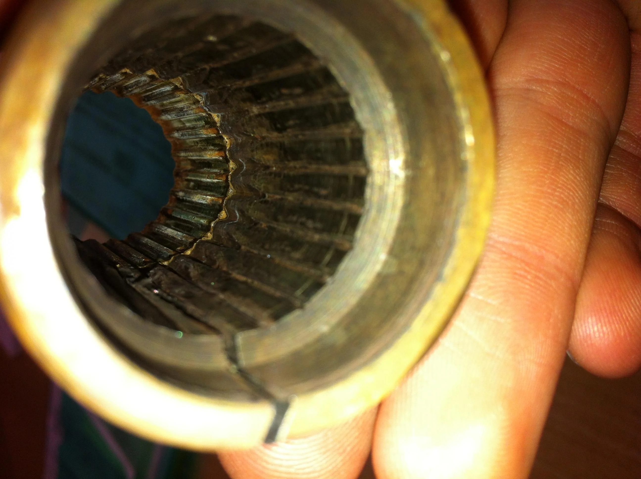

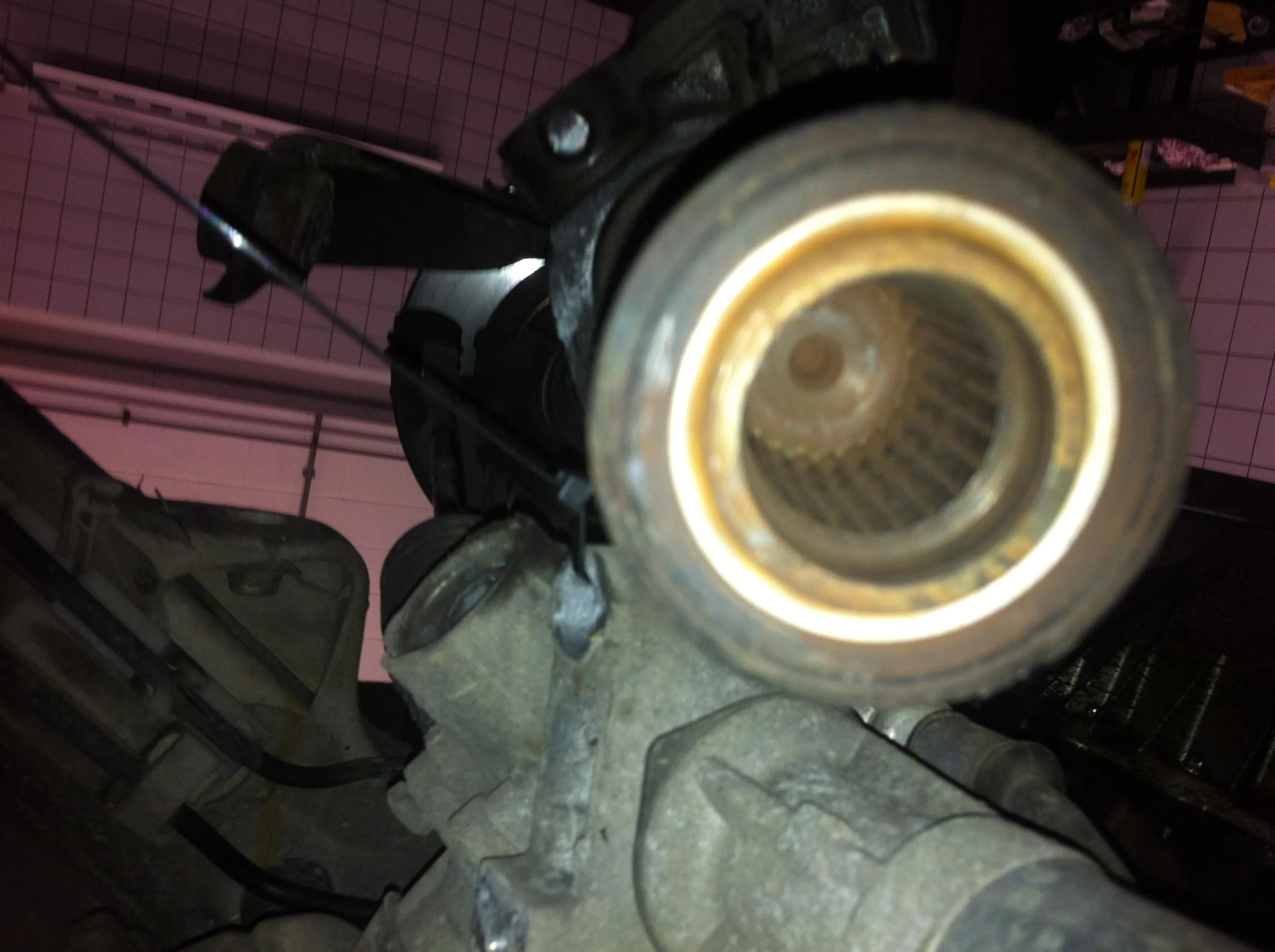

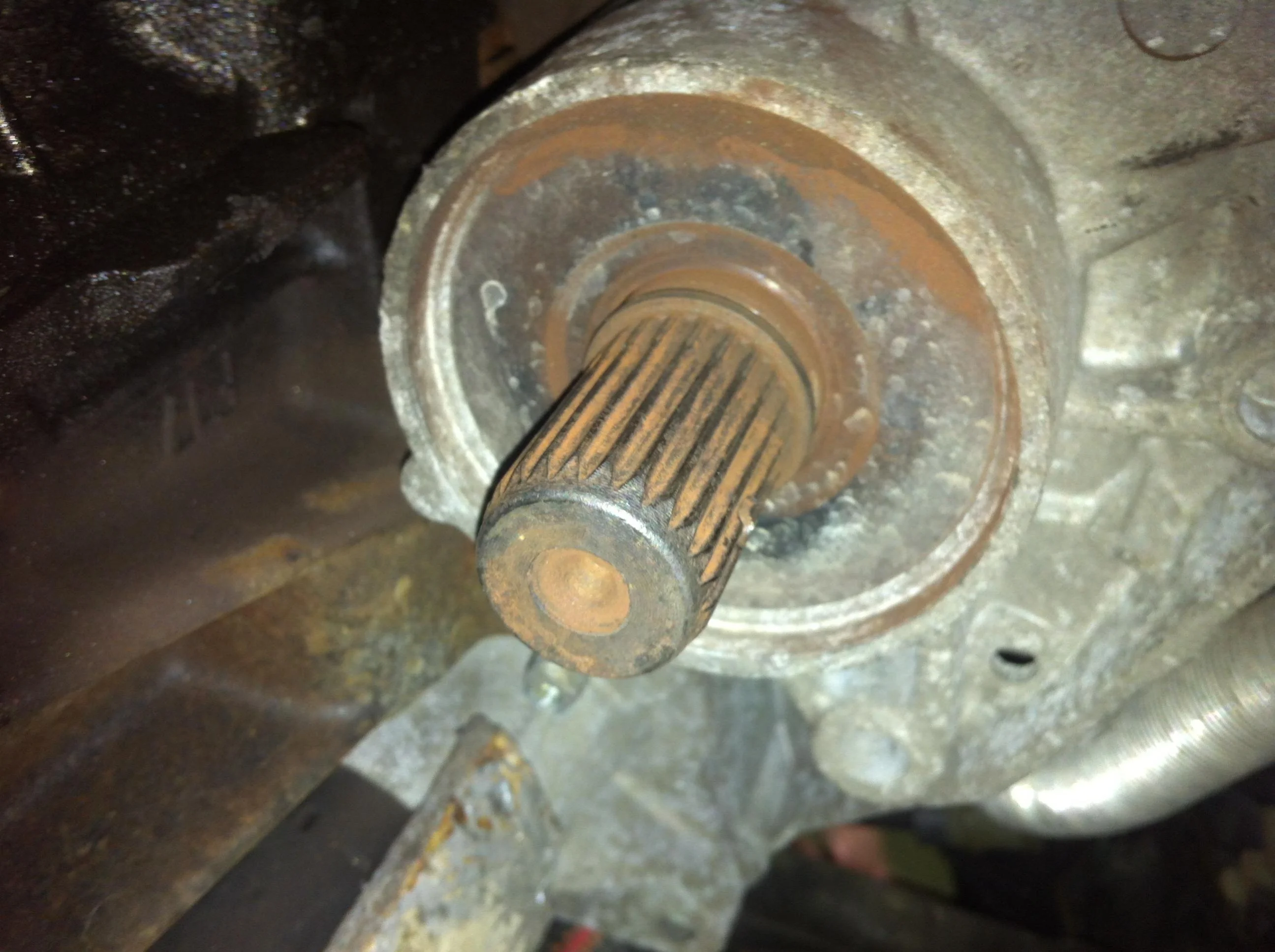

and here is the photos of the spline. Gearbox spline looks fine and felt fine, differential spline all smooth!

Here’s a photo of the splinth. You can see the closest part is all smooth and the far part that connects to the driveshaft has all the right grooves in it.
Hence why I lost all drive!!
