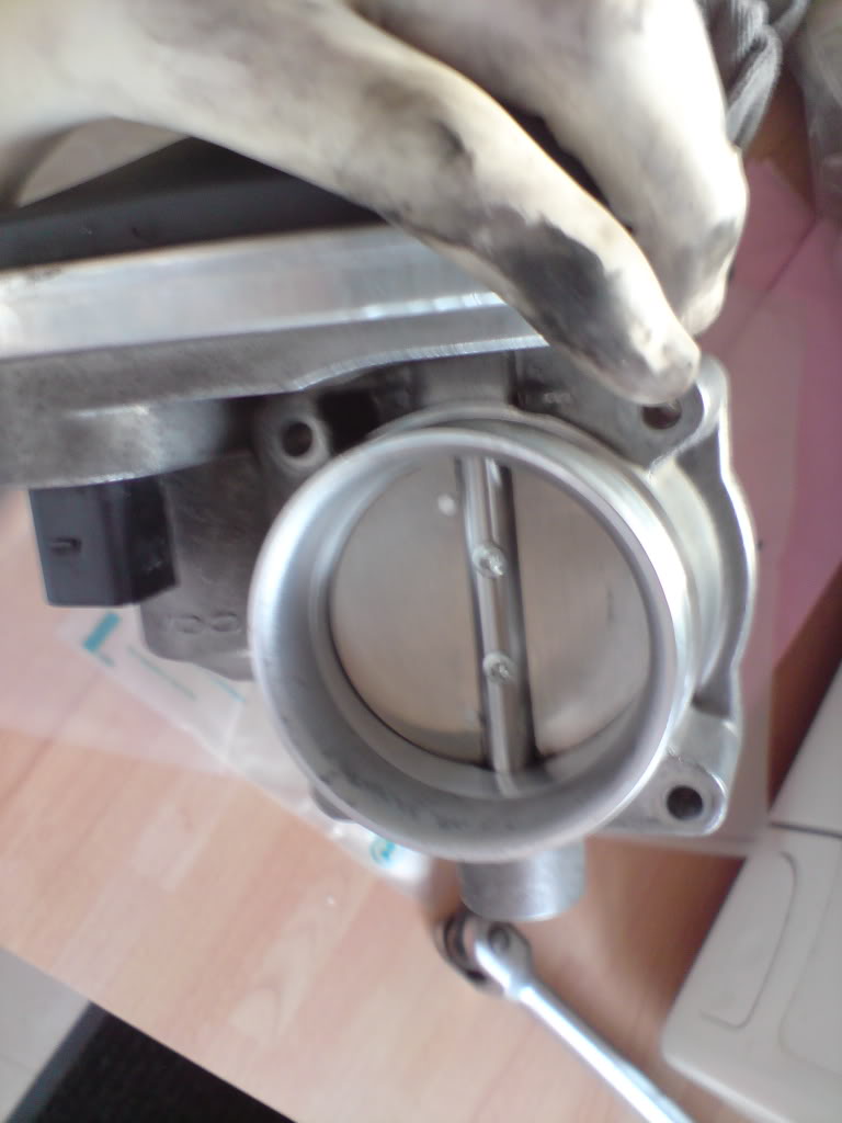

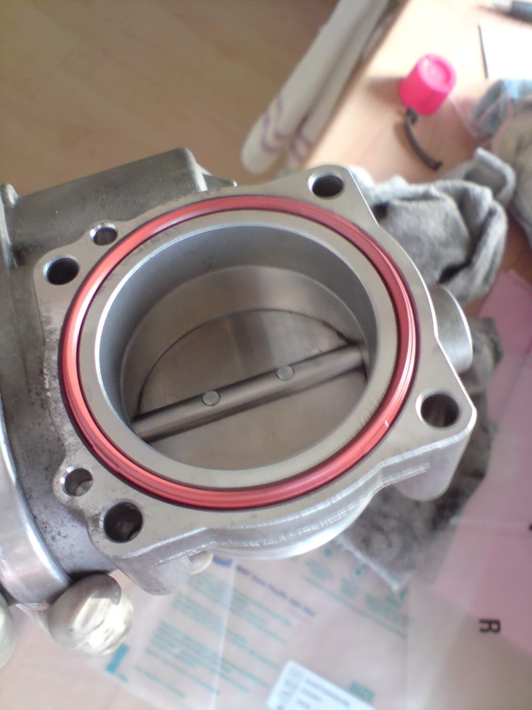

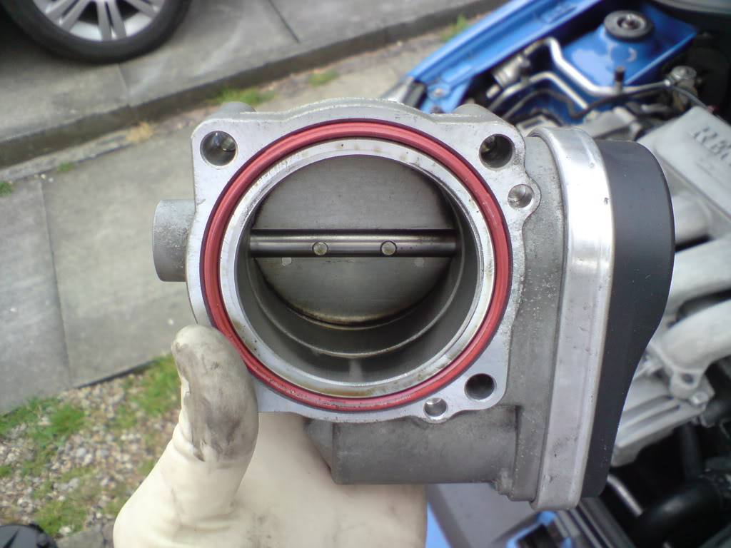

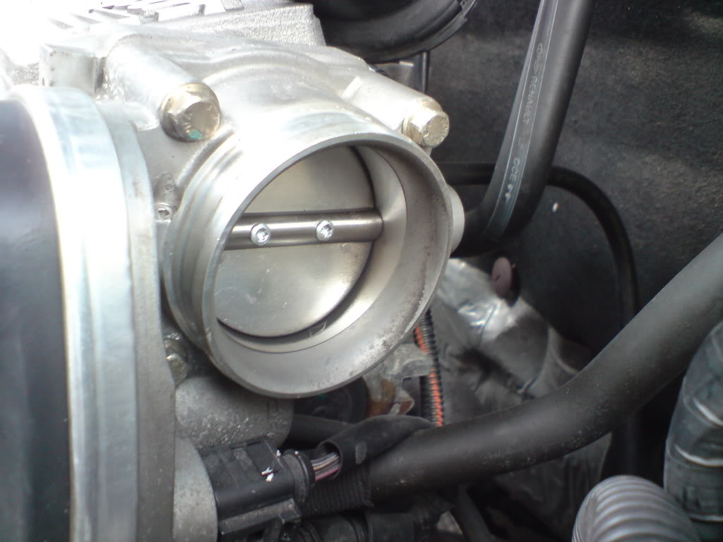

When i had the clio serviced in October i had the TB cleaned for the first time after 48K (looked cleaner than these pics). Anyway, put a K&N cone on at chrismas and now look at it. Took it off, gave it a clean and you can see the difference.
It made a nice sound i might add, but i was never convinced it made a difference to throttle response. This sort of proves the opposite. I think the noise tends to make us think that there is more power there.
I've stuff the OE filter on for now with the acoustic valve caf disconnected and it sounds just as good. Got a V6 box waiting to go on (maybe). Still can't decide.
Moral of the story, dont buy cheap filters.

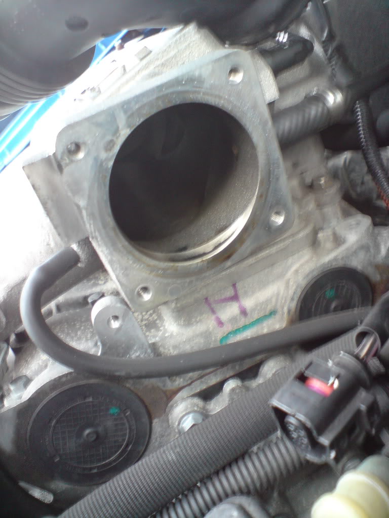

Also, stupid question, but is the plenum supposed to be wet inside? :S

It never used to do this though. why now? it was a bit oily by the breather pipe in the elbow. It looked like there was oil in the plenum when i looked in.

the TB is'nt getting dirty by a "cheap" K&N (which are good filters) ..
The crankcase breathertube connected to the elbow frequently spits out oilfumes/residue which is sucked in to be burned .. Evironmental friendly design , sucks if you want to keep the TB clean. That would be you moist inside there also m8
You can disconnect the tube, block up the hole on the elbow (or buy a nice aftermarket one without the hole) and stick a little breatherfilter on the end of the tube, or a oil-catch tank which can also look pretty damn nice in the bay.
I just went for a breatherfilter, sometimes the burned oil-smell travels through to the cabin though..:dead:
