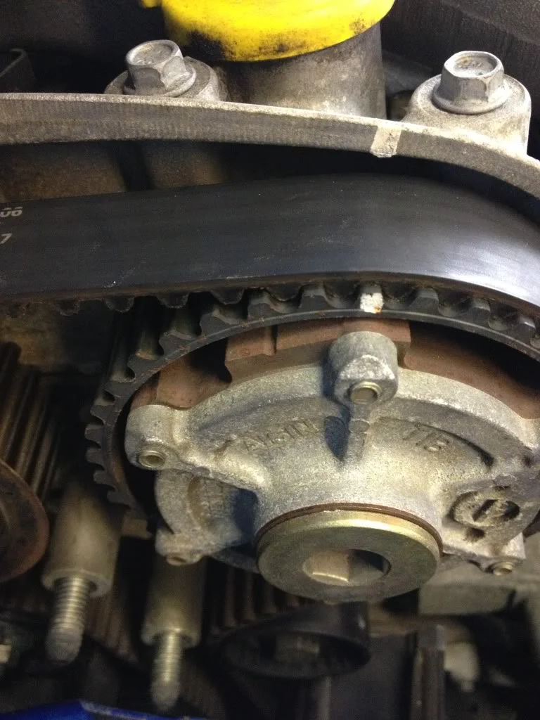

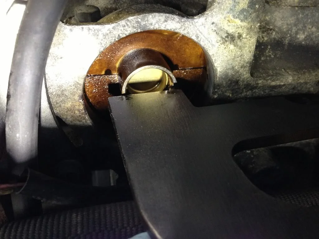

Replacing the belt on my clio 172 cup and iv come accross a problem:
The timing tool that goes in the cams to lock them in place is not lining up on the inlet side, looks like it needs to be rotated anit clockwise. But looking at the dephaser side the marking on the rocker cover to the markings on the dephaser are slightly out and need to go clockwise. I dont want to under the dephaser just in case it needs to locked in place - does it need to be? or if i undo the dephaser pully will it just stay in the same place where it is now? Pictures below.
Also on the dephaser pully there is a marking (left hand side of the white tipex mark) what does this need to be lined up to or doesnt it matter?

Your timing is out and that's why it won't go in the slots. The white marks just show that after 2 revolutions they should line up again.

Yer i know the timings out but i really want to know weather i can remove the belt and the dephase will or wont move??
i know how to change a cambelt!, im just unsure on how these dephaser work when changing the belt??

If you have changed the belt and tensioned correctly then all you need to do to get the cam timing back is:
Lock the pulleys with the correct tool, undo the dephaser then rotate the cam back into place and re torgue the bolt.
Its important to follow the correct tensioning procedure to make sure you have even tension throughout the belt (the rotating it all backwards part)

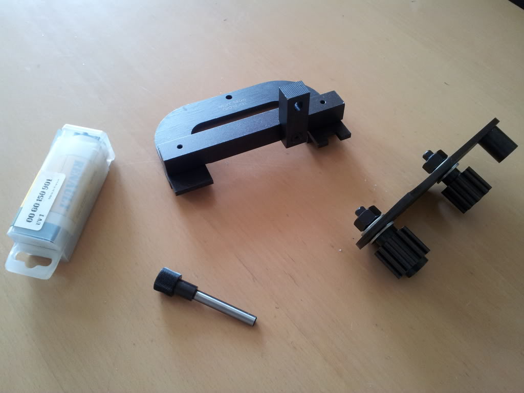

Thanks for all you help lads, I get the bit about loosening the pulleys to take up the Slake in the belt, basically like anyother cam belt that has flouting pulleys. I just really want to know if the dephaser is under any tension when the belt is still on?? So when I remove the belt the dephaser will not need to be preloaded if it does have tension??
The timming tools are AST(I think that's the make lol)

As I said the dephaser shouldn't have any movement in it when you remove the belt. If it does it'll need replacing!

no, it's not going to go anywhere, it only moves under oil pressure, and moved back to locked when pressure drops.
as already said, your locking tools aren't much good, I wouldn't use them.
