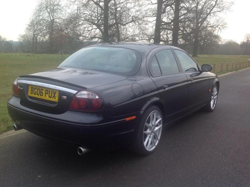

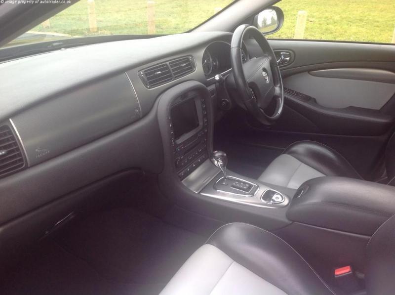

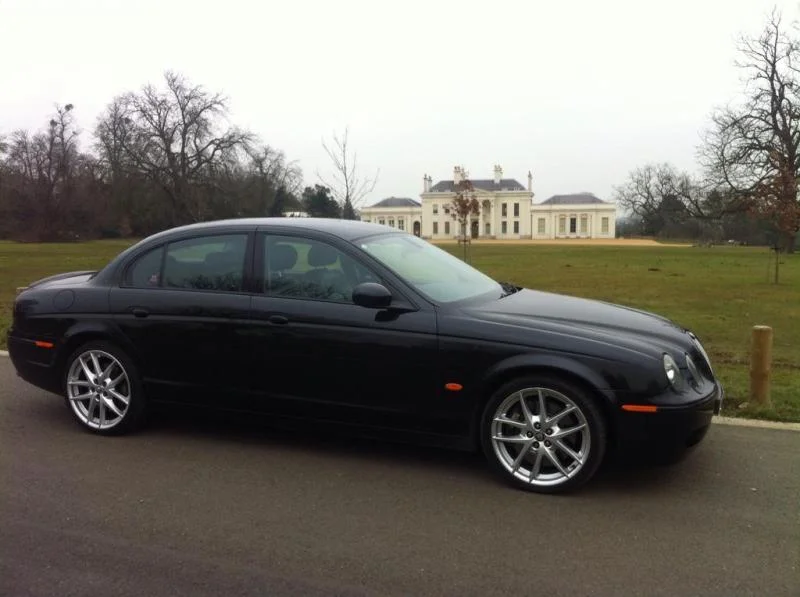

And i bought this yesterday (Jaguar S Type R) to cheer myself up (and because the misses wants a 4door car as well)
406 BHP and 554 NM torque, it's like driving a luxury sofa on steroids!
