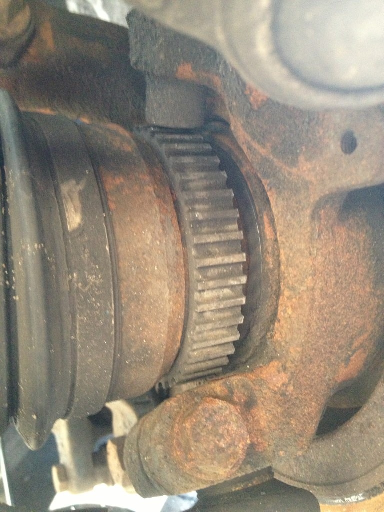

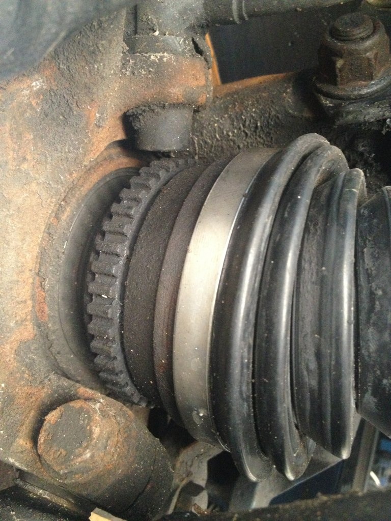

Was under my 182 Cup at the weekend and noticed the drivers abs ring was a lot fatter than the passengers
ImageUploadedByTapatalk1376310227.951372.jpgImageUploadedByTapatalk1376310241.644422.jpg
Is this a non-cup driveshaft? Might explain why the abs has felt 'weird' since I've had it!
  PB172,dci100,dci65
What I can add is that both my clios dci100 (04) and 172 ph2 (01), have the more narrow one on and ABS workes fine.
..but U have a thicker sensor too.
  Phase 2 172
Thought so Dan. Like I said its been like that since I bought the car (2 years ago) and has driven fine
Will exchange it when I have the time/money!
I bought 2 exchange shafts from renault and one had the big ring and the other had the small ring, made no difference to my car at all and fitted fine
