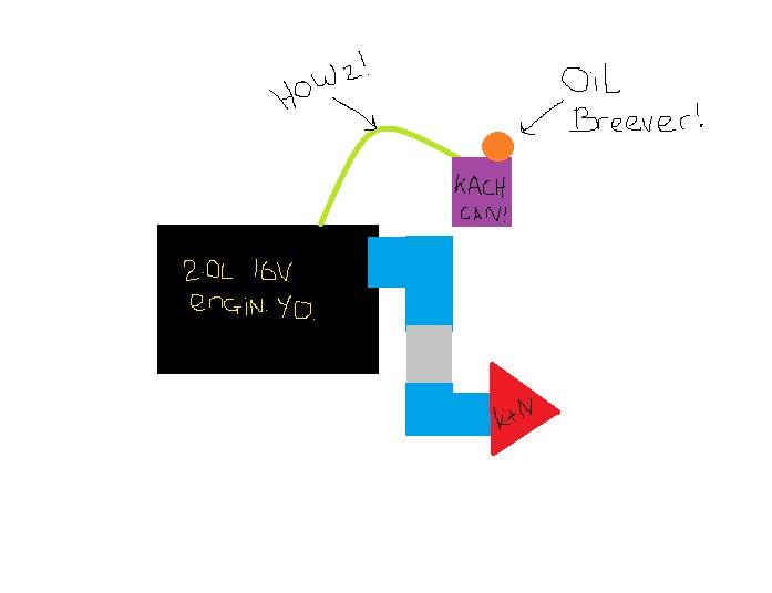

Catch tanks are easy! Fit your DIY induction kit (I'm contemplating one, routing it down to behind the front N/S wheel!) and then run a hose from the rocker cover oil breather nipple to the catch can, and then fit the oil breather filter to the other catch can hole! See my paint diagram!
Oil Breathers fitted to the rocker cover clog up with crap and go all horrible! Catch Cans means you can empty that crap out!

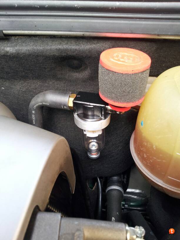

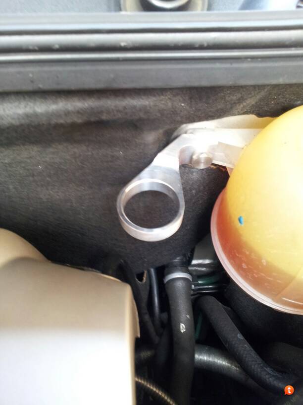

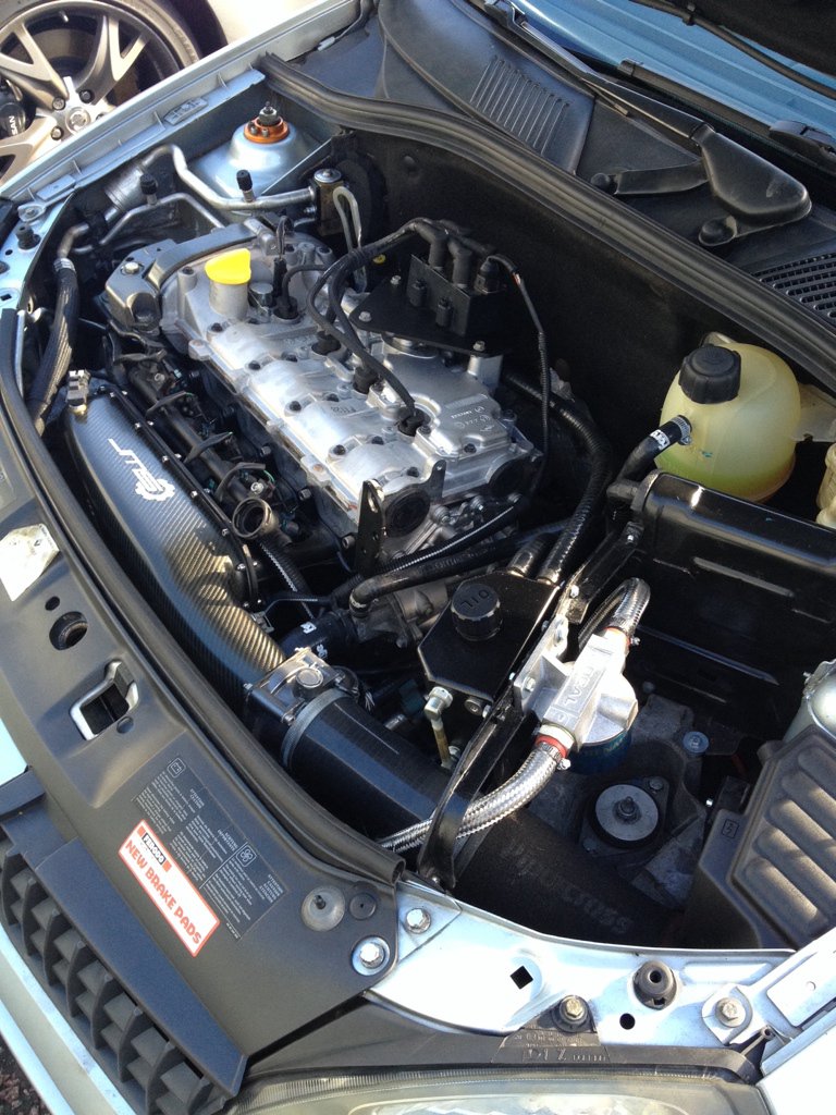

Heres mine Danny bracket from solid piece of ali
Cheers Pat
Awesome that is Pat. Great bit of work!!
I want.
This is mine, the catch tank is now located between the pas reservoir and the coolant bottle. Looks alot tidier now (need to get an up to date picture)

Pat 182
  cliosport 182

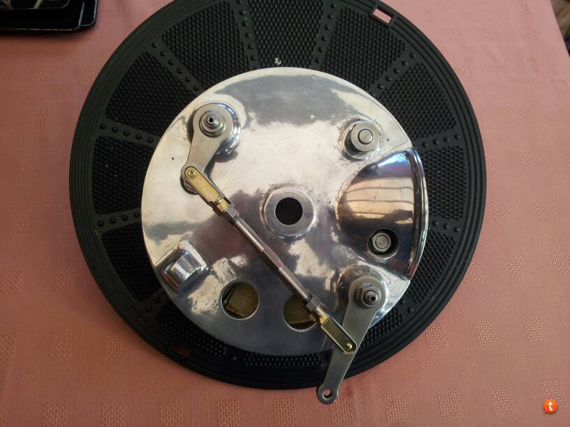

Wasn't planning on doing another let alone afew more??!! lol:eek:

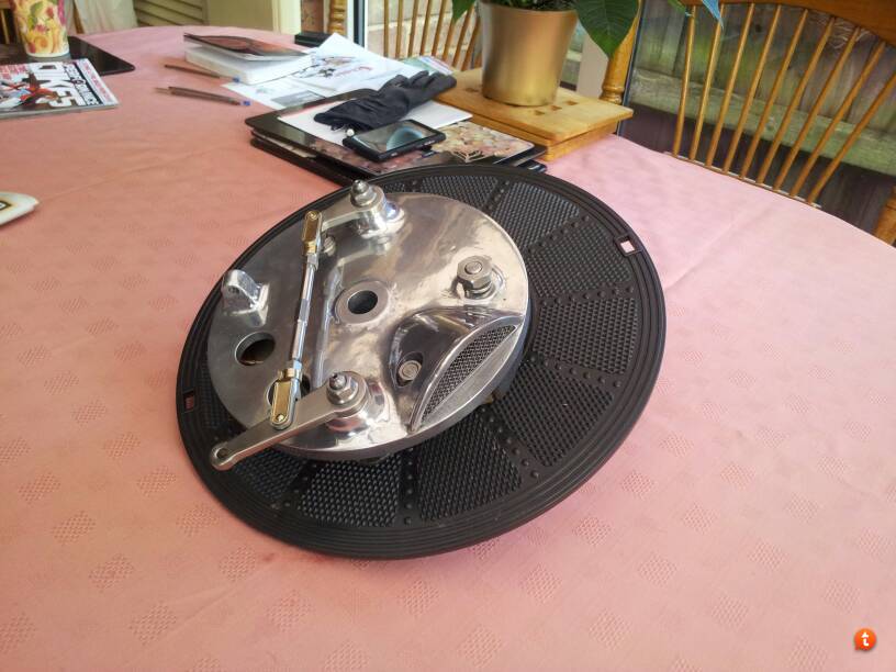

The machines I use at me dads are tied up for a while making bits for old motorbikes?! Sorry
My dad make twin leading shoe front brake plates for BSA GOLDSTAR'S
Pat
Pat 182
  cliosport 182
Never say never mate ;) the one on mine took forever?! May have alook at some less machined jobbies??!!
The brake plates above have so much machining on them and it takes a lot of time!!
Pat
