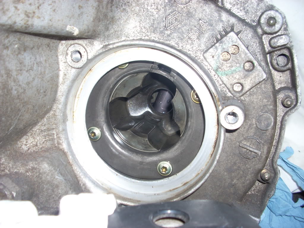

I've got a JC5 130 without the speedo hole or worm drive, at home with pretty much every tool available is it possible to change casings for a knackered JC5 with the hole and also to fit the worm drive part?
Anything to look out for flying out when I open up the casing?

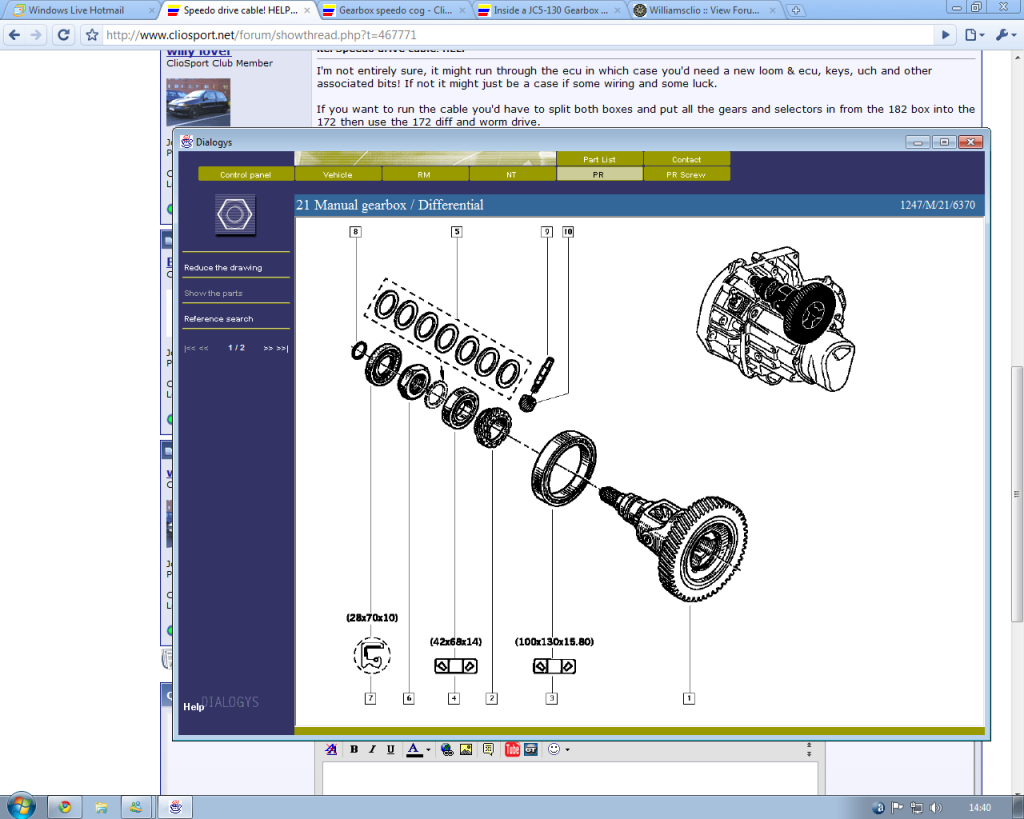

I wanna fit these parts
