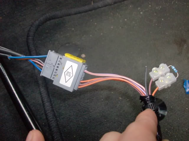

just fitted ph1 172 seats in my ph2 dci. the airbag clips are totaly different! can the loom be bypassed under the seat or is there ways of connecting them or changing the pretensioners over without being K.O'd by an airbag going off? need help BADD! cheers!

Get a Maplins resistor: Code M3R3 and do the following to fool the airbag ECU.

Doing this will disable front seat airbag's.
Just do exactly as the picture, it's a easy job.
