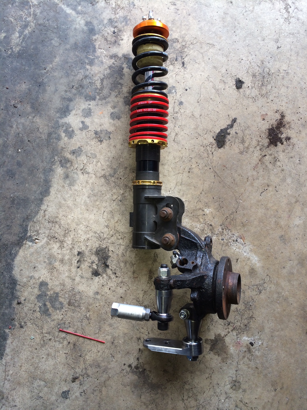

One other thing worth doing, is some roll centre correction when you lower it:
This is mine:
Its a kit made and sold in a group buy by a couple of guys on here, 625 quid which sounds steep but its actually more work than it looks, but again im sure its stuff you could make yourself anyway if you need it.

Roll centre kit looks good and definitely an improvement. Not something Ill be buying at that price however!

These cars are easy to get carried away on, but the one you sent me the link for looks like the hard work is done anyway, and despite morgan getting a massive hard-on over cups, there really isnt any difference that would be relevant to you, although do check how they have done the aircon delete as some methods are better than others!
The roll centre kit is money well spent TBH, the difference on turn in is quite noticable, because people normally change the spring rate and hence massive alter the roll resistance at the same time as they lower it, they dont normally notice the negative effect the roll centre change has had, its only when you fit the correction kit you realise!
