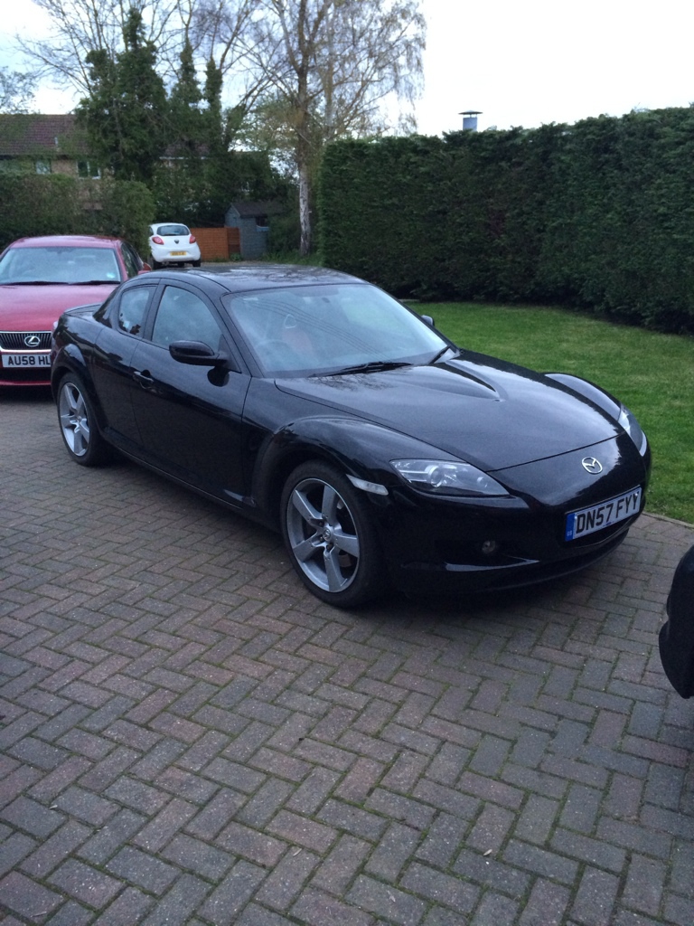

It's a black car, Paint isn't too bad in general but obviously very swirly, Think I'll go with both Rejuvenate and Blackhole.
Wax is predominantly looks I reckon, Its for the Gf's brother so just want it looking as good as possible when he picks it up.
Rejuvenate + black hole will bring that up great. Love that combo on black, adds so much depth even before the lsp goes on.

I'm looking forward to seeing how it turns out, Tempted to use my DA to work the Blackhole but having not used it yet umma little worried on soft thin paint.
Finishing pad on a slow speed??
Scrooge
  E55 AMG
100% use the Da to work in the black hole, finishing pad and blabkhole won't cause any issues even if you held it one spot for ages :)

Just gotta hope for nice weather tomorrow and Monday, Will try and remember to get loads of pics and do a small write up.

Getting the RX8 left with me tomorrow to get started on then all of Monday :)
Can't decide what to use once full decon is done.
Poorboys Blackhole?
AF Rejuvenate?
Both??
Which wax?
AF Desire
Purple Haze Pro
CTR
CTR for looks. Stunning wax!
