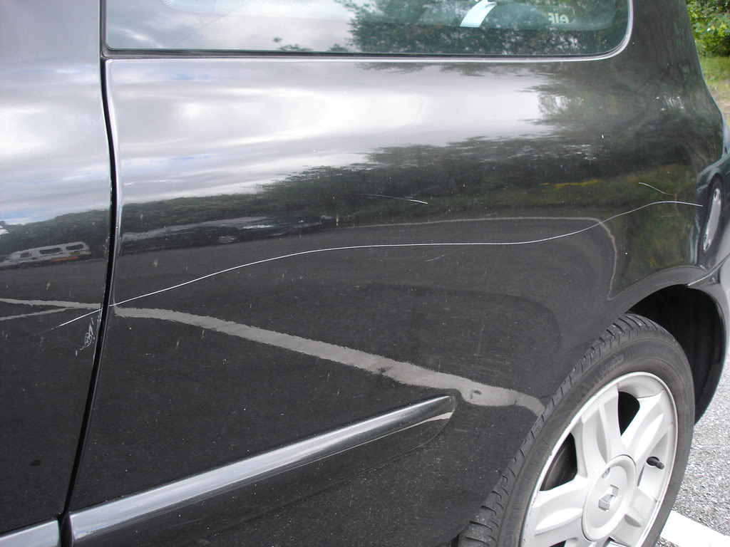

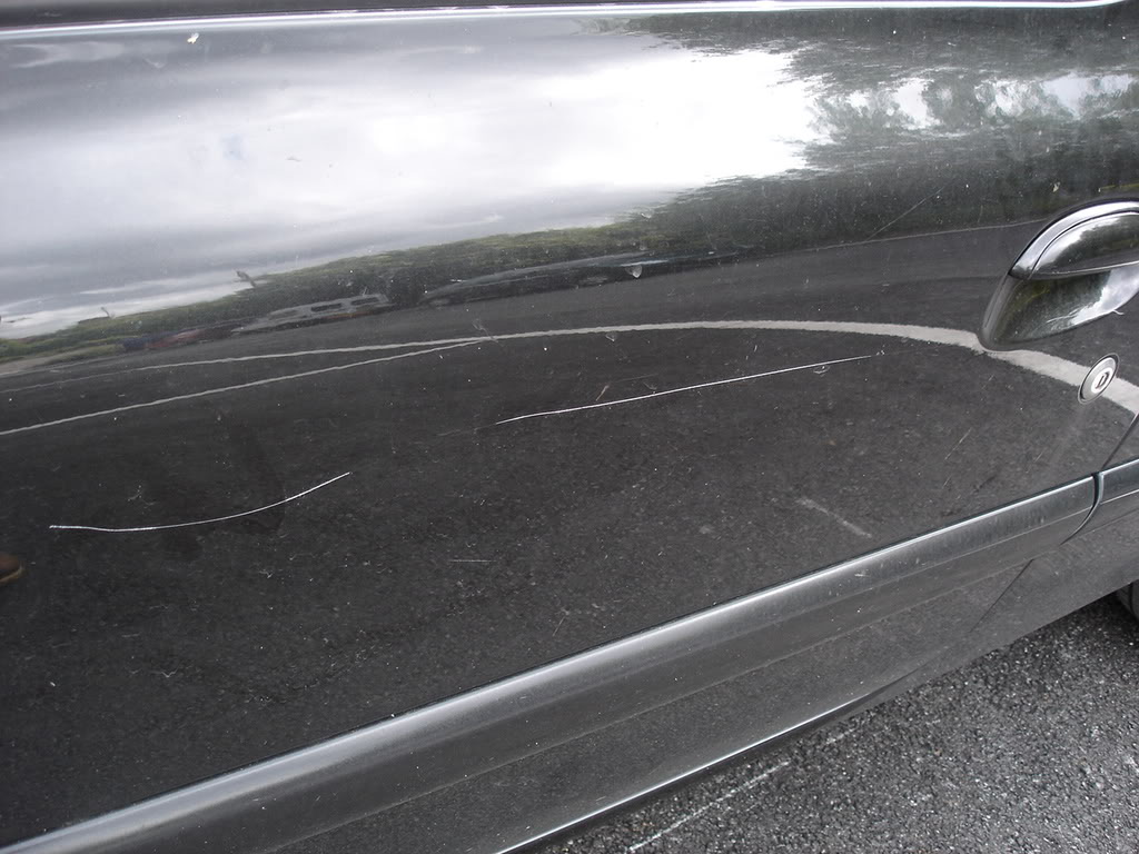

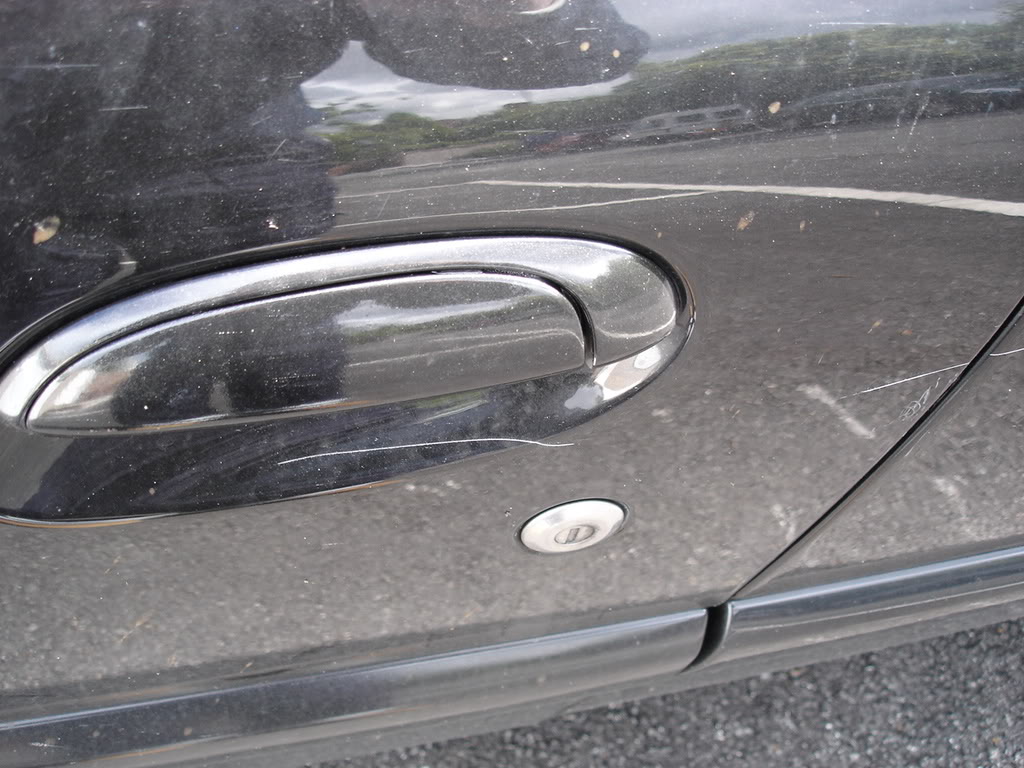

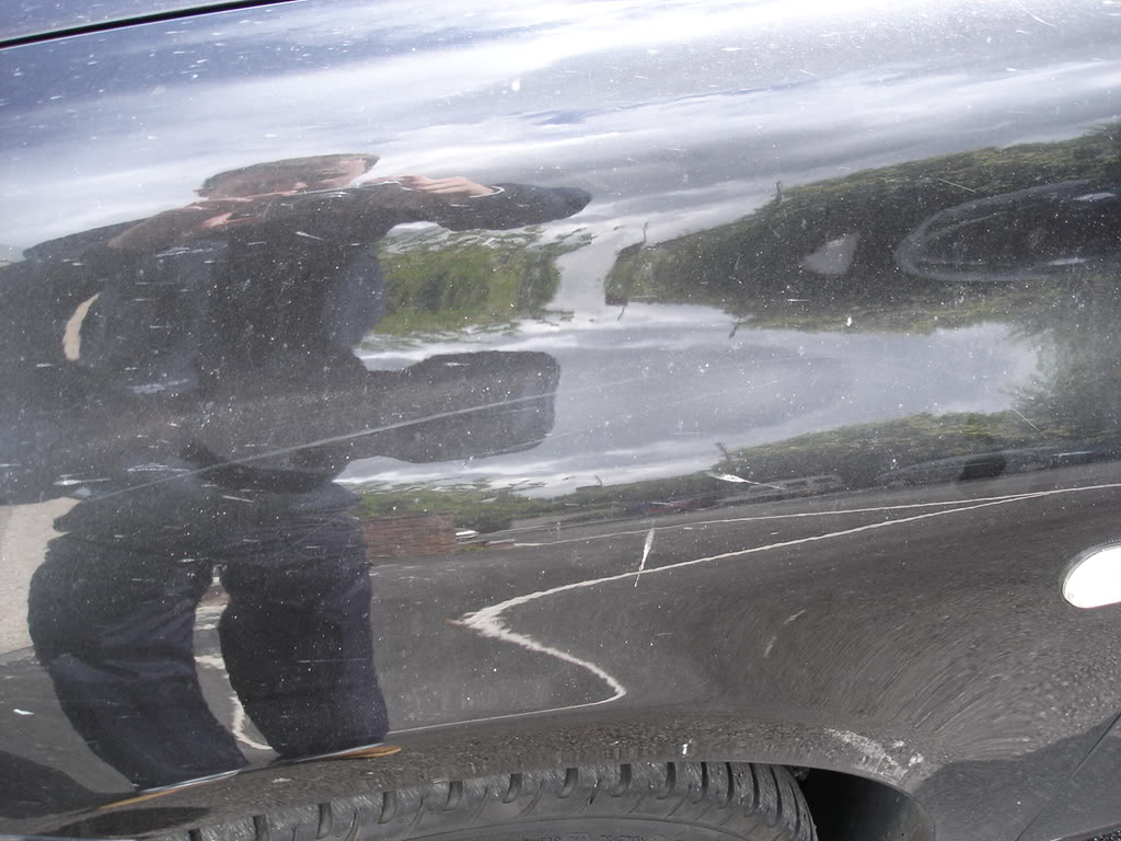

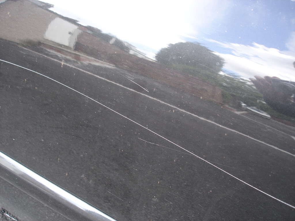

right im f**king fuming atm because some little b*stard has keyed the entire lengh of my car today whilst i was at work! its on all 3 panels along the side of the car (wing, door, rear) and is quite deep in places - its quite rough to the touch and i can feel it with my fingernail. not sure if it just the primer underneath or if its the bare metal but its extremely noticable and i want rid of it as cheap as possible tbh!
it doesn't end there tho ...the little f**kers have keyed all the cars that belong to the lads i work with (about 15 or so). the gaffer has said we cant park in the yard as there is no room for the fleet trucks so we have to park on a residential street next to the yard! the street is obviously used by residents to park to but surprise suprise none of their cars were damaged! its just ours that have been damaged!! each one keyed along the entire length of the car! ...even the gaffers new volvo was keyed!
how can i get rid of this guys? i just need the cheapest option really as i have a baby due very soon! dont mind a bit of hard graft and lots of elbow grease!!
pics of the damage! oh yeah the car is absolutely filthy to:

If you can feel the scratches with your fingernail usually means the panels will need to be resprayed, not the news you want to hear...sorry

Will need paint. You may get somewhere with touch up painting and wet sanding but being metallic you will struggle to get it sorted as easily as you would a flat colour.
The problem with deep marks like that is being able to build the paint up proud of the damage they look quite seep. :(
Worth a try but you will pretty much be guaranteed you will need to get it painted properly.

Seriously it'll need paint that. General rule of thumb....... if you can feel the scratch with your nail, it cant really be polished outwith a machine. It might be improved on slightly but thats it. Yours is far too deep imo, looking at yours its down to the primer!!! I have a PC so have some knowledge on paint correction
