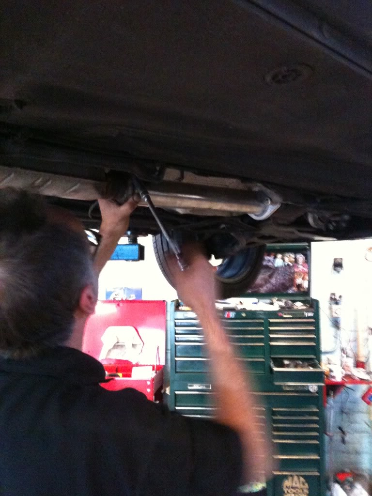

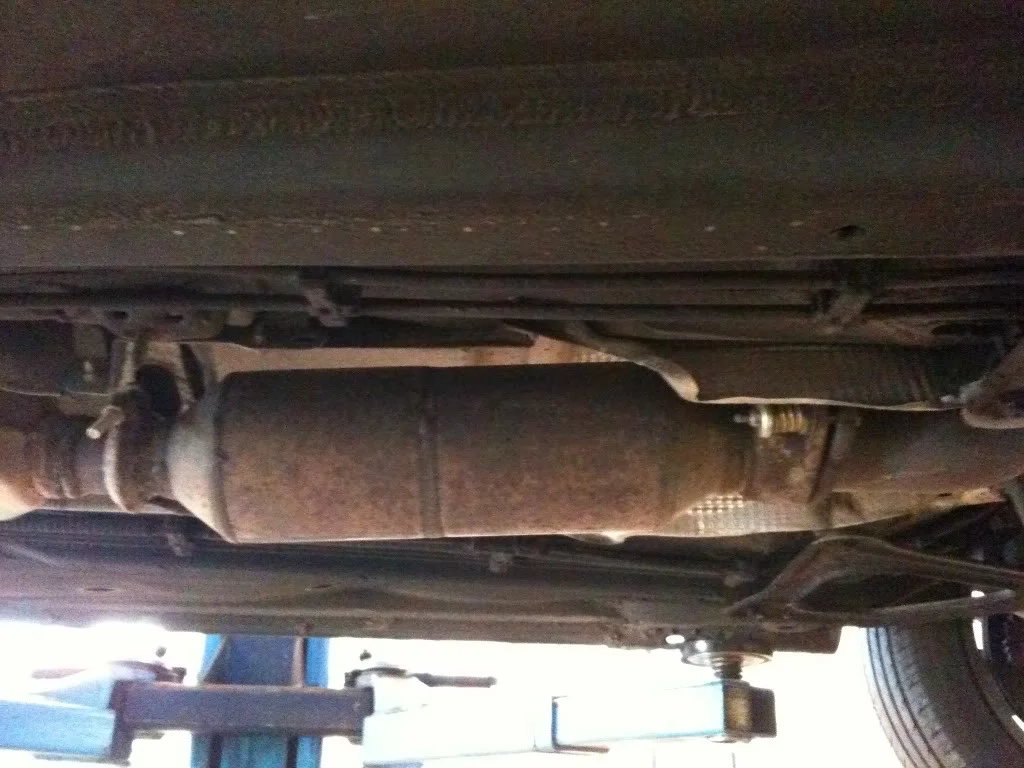

not sure if these help but look at mine when i did it, easy peeasy...
you can see its really easily accessible, get under there and have a go!!
Oh and lambda came out of mine quite easily, swift tap with palm of hand with spanner on whilst exhaust is hot and turned straight away, i can imagine it being harder if its cold, but the cat stays mega hot for bloody ages!
