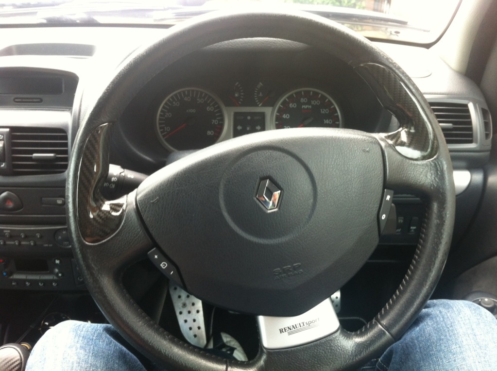

Since I got my tracking done a few days ago ive been having a weird problem with turning left. The wheel is dead center when driving in a straight line but after i take a left bend the wheel seems to return to a slightly wonky angle.
Its a bit hard to explain but its like having a dead spot in the steering from the wheel being exactly straight and it being turned around 20 degrees to the left.
So it ends up going something like this:
Driving in a straight line... steering wheel is dead center
Take sharpish left turn then drive straight again.. steering wheel is in the position below
The wheel will only return to the proper position when i take a right hand turn and straighten up again.
Im going to go back to the place to get them to redo it when i get back down there other end of the country unfortunately so i wont be there for a few weeks. Anyone have any idea of what could be causing this?
