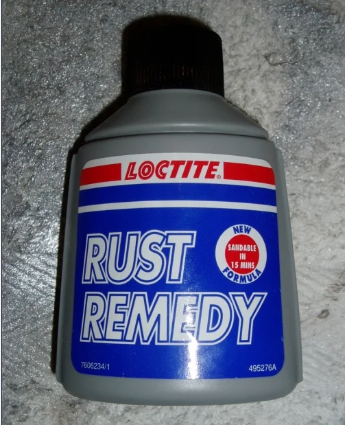

You need to stop the rust from coming back . Is it bad enough it needs filling ?
You can get this to paint on before you ,fill or prime it kills rust .

those remedies are only temporary, to do it properly all the affected metal needs removing, putting that stuff over rust will not cure it
I've used this stuff loads of times , wrought iron gates , fences etc ... paint it on , paint over it , rust never came back .
But i agree if the rusts that bad , it will need cutting out if its only surface rust this stuffs good enough for me .

Most car arches rust inside to out so its more than just surface rust, there is where the problem lies.

a gate is slightly different to a car panel though, have you ever tried it on rust on a car panel ?, ps if its surface rust then there is no need for that stuff as you just take the rust of and its no longer there , but im guessing his problem is a bit more deep seated than that, believe me and the best way is to remove the metal of grind it back till its gone, if it coming from the inside then it needs new metal putting in (or new wing) to cure it properly

In my experience (thankfully not on my own cars) rot will reappear at some point when a rust "cure" is a applied. Either needs grinding or cutting out and any metal removed replaced with new rot free material.

im with MRBILLYUK on this one guys...the rust wont come back if you do it properly. first off, you need the air (humide air at that) to make it rust, if its sanded down, painted with rust remover/preventer and then primed/painted properly the rust wont come back for the simple reason the metal is sealed under the paint. rust isnt an infection... its a reaction.

This all depends on the severtity of rust which is impossible to tell until you sand down and start giving the suspect area a good proding ... oh er! ;)
Providing it is just suface rust then it may be sortable without any major metal work, unfortunatley in most situations rust goes deeper than this, as cars tend rot inside out. This is when rust appears from under what was before perfectly good undamaged paint. If you remove all the rust properly in this situation a new panel or piece of metal will need to be welded in. This is common for wheel arches and sills etc.
A stone chip that has broken the paint and gone rusty should be sortable with a sand down and rust treatment as this wont have rotted inside to out.

any reports yet ANTH, i personally would still go for removing the rust as i said way up the top (whether it be by a quick sand on surface rust, or angle grinder on deeper rust, or completely removing it on badly effected metal), its the only way you will know it wont come back, i would not rely on just covering it over to cure it.
This is where your ignorance is showing then as its not a covering , but it actually neautralises the rust , killing it dead and preventing the reoccurance of new rust .
Do you really think that a company such as Loctite would release a product into the market place that doesn't actually do what it claims , with the consequence of tarnishing and causing irrepairable damage to the brand name ? I don't really think so !
I work for a large chemical company , and many millions of pounds are spent on research and developement of new products and many thousands of man hours go into the rigorous testing of such products before they are released into the market place . We and i'm sure many other companys such as Loctite would go through a similar process before they are 100% comfortable that the product will do exactly what it claims to do and won't actually fail .
But i guess to the uneducated , this process isn't something that is often thought about .

HeheheheheheheheHHEHEHEHeheehehe..... oh dear lol...
Started sanding off the rust... part the rear arch was marvoulous and the rust went no problem... the bottom part of the arch how ever... well lets just say, are cars suppose too have holes? anyways i've started filling the hole in :| lots of work to be done, it's all good - I think :dead:
