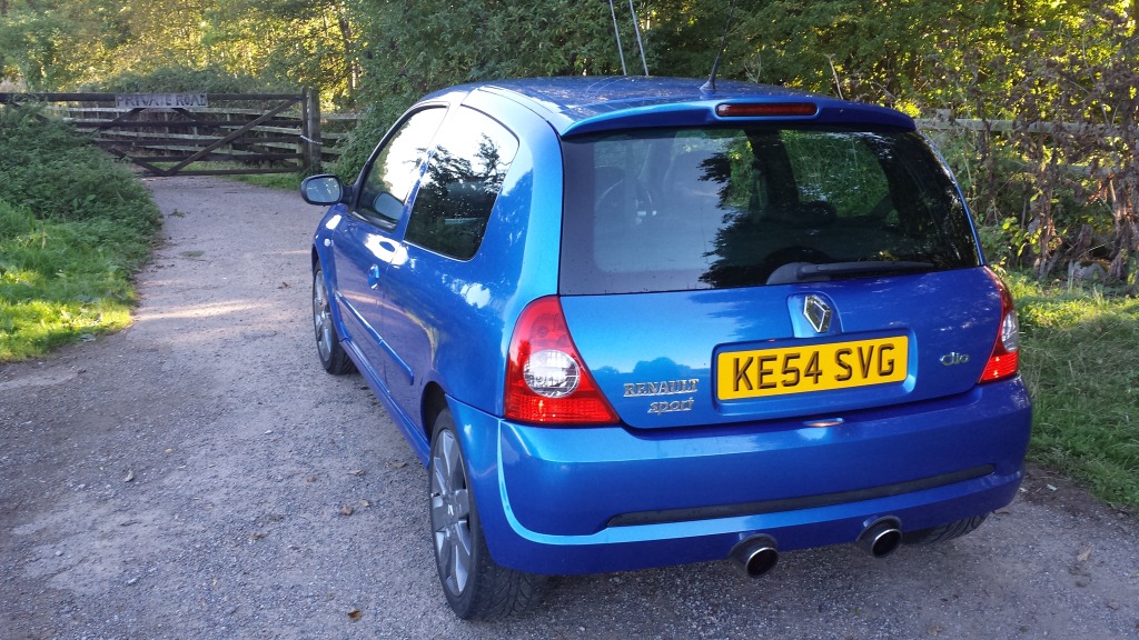

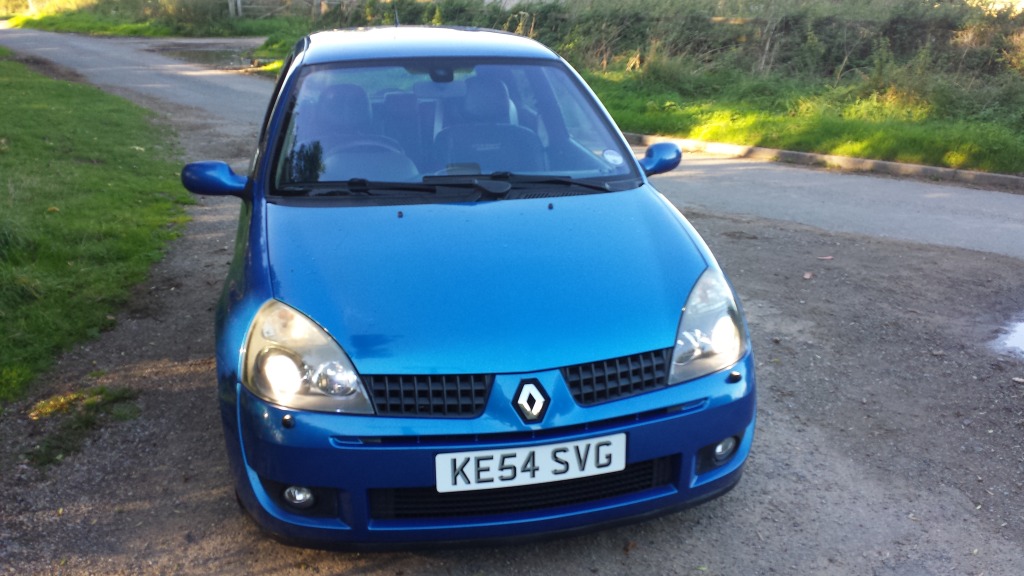

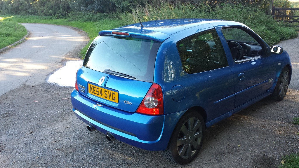

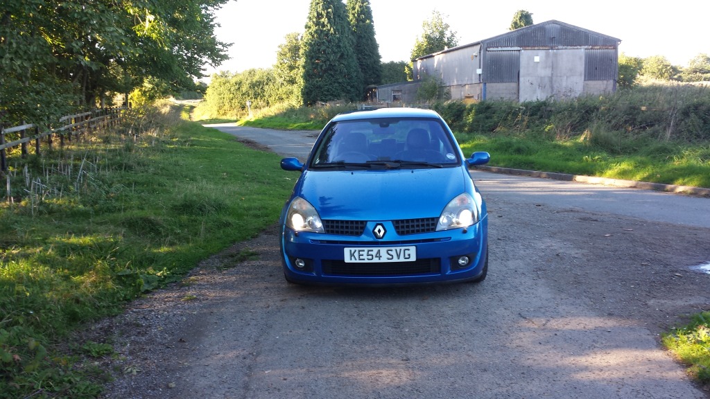

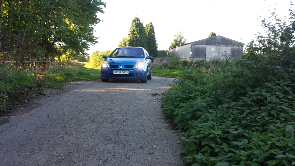

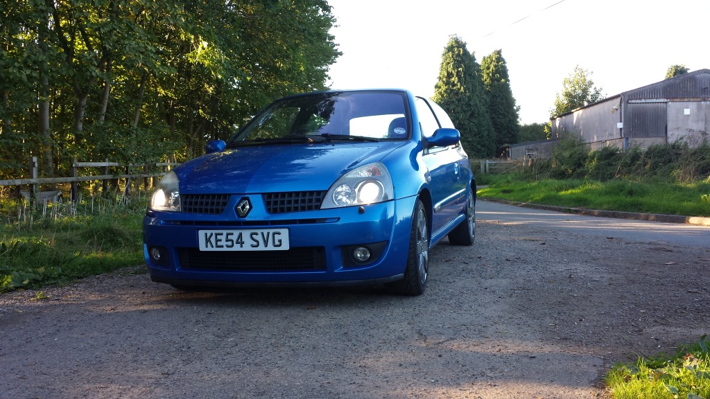

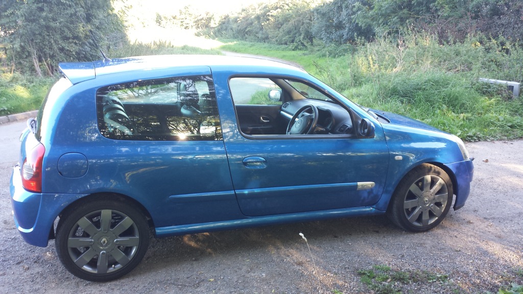

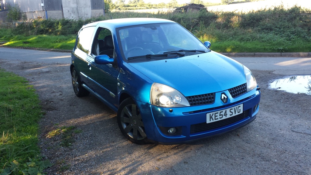

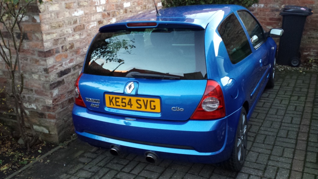

I thought id start a thread for my clio 182. Its a 54 plate with both cup packs and has covered 81k miles upto now.
I have owned the car 3 weeks now and love it so far. So far i have done the following:
New number plates as the ones on the car were scabby (altho i may go for a 3/4 size plate on the front soon)
New drivers side tail light as it was cracked

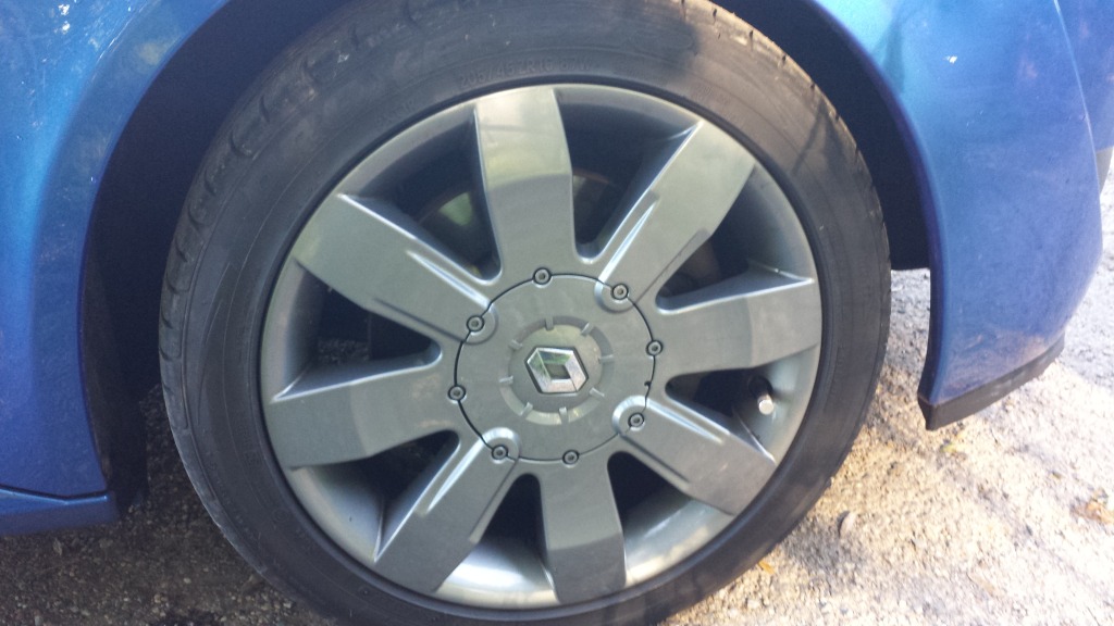

bought a centre cap for one of the alloys as one was missing
applied several layers of polish:cool:
I dont have big plans for the car. Only immediate plans are to get the bonnet resprayed as theres a fair few chips on the bonnet. The rest of the car is in realy good nick.
im also looking into giving it a subtle drop just to make it sit nicer, been looking at the cooksport springs.
I also plan to get a pair of toyo proxes t1r's for the rear. The fronts have a brand new set of toyo's on but the rears are miss matched cheapo's .
I will probably do few other bits and bobs but i want to keep the car looking nice and subtle.
I will update this thread as and when i do bits. Im not in a huge rush though as perfection takes time:cool:
also you cant realy see it in the pics but the headlights are slightly cloudy so im going to give the 3m restoration kit a go sometime soon
thanks for taking time to view this.

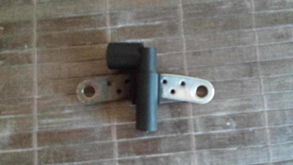

I finally got round to cleaning my crank sensor this weekend.
the car has had a bit of an intermittent start problem since ive had it. If you turned the key to start the car, sometimes it would turn over,stop, then turn over again and start. Other times it would turn over a couple of seconds before firing up. Most of the time (80% or so) it would start up fine. However, it was obvious something wasnt quite right.
so after a bit of research, it became apparent that the crank position sensor could be at fault.
After finally getting it off, it had a thick layer of surface corrosion. This is a pic of it, with one side polished up and the other as i found it.
as you can see, a big difference.
fitted it back in and the car now starts straight away every time.
it also seems smoother on tick over aswell?
It appears to have cured it, so jobs a good un.
if anyone else has this problem id recommend trying this. It takes about 20-30 mins and all you need is 10mm socket and ratchet.
gave it a good clean today too:approve:
Rubicon_
Ahh I thought the bits at the side of the sensor were just to mount it. When I took mine out I just cleaned the little magnet bit on the bottom, this will explain why the fault has started again!
  clio 182 FF
You might be right. i cleaned the whole thing. There is also a bit on the bottom which i cleaned aswell. after the going on i had getting it off, i just cleaned every bit of it, including obviously the pins, which were just as bad as the outside.
