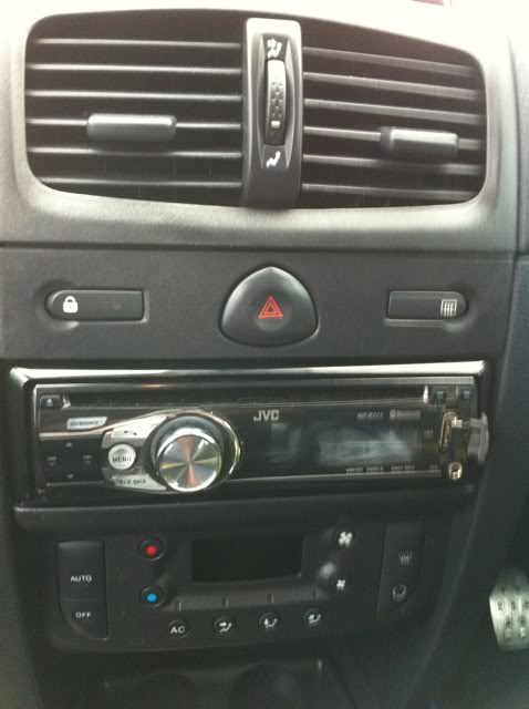

If id done it without thinking i wouldnt have been so pissed at it for been stuborn but its just one of them things.. All i wanted to do was get my HU and handfree all set up nothing amazing and its turned into a right arse..

Well after all the back ache and swearing at plastic yesterday I went out today and within two minutes it was freed and in my hands..
I was well happy at the ease but annoyed it had fought so much yesterday.. Hour later were all plugged up and running..
Result!! :)
