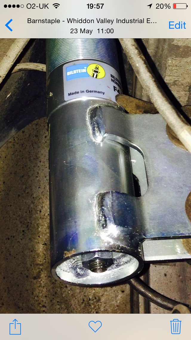

Yeah interesting. The bigger damper can give a better damping feel but can have sometimes have a negative effect on track when running without a piggyback/ remote oil reservoir as the bigger piston diameter gives a smaller oil cappacity, thats why for eg the sachs dampers have a reservoir. The oil can heat up faster and cause performance fade. Wander if that's why some people have slated these on track hmmm but im no expert lol only going of what ive been told in the past. As these predominantly get good reviews both road and track

I'm pretty sure they are AVO, as when I've tried to find longer springs, all the diameters bring up there's as options.

Not sure that's what is happening with these, it's hard to explain but the reason they are such big diameter is because that part is the fluid part and the damper, the rod you'd normally see on other shocks is inside of the leg and bolted to the bottom, or did you know that?
Ahh would explain the AVO sticker on the back dampers lol i thought that was just a sticker someone had put on, I cant say ive ever really heard of them. Might do some digging haha :up: they had some beefy diameter piston too
  CLIO 182
Not sure that's what is happening with these, it's hard to explain but the reason they are such big diameter is because that part is the fluid part and the damper rod you'd normally see on other shocks is inside of the leg and bolted to the bottom, or did you know that?
Yeah I did buddy, sorry if it sounded like I was slating the bigger diameter I wasnt lol they are far more superior as they can transfer a much greater force. And typically the bigger diameter dampers have a much higher oil viscosity to compensate :up:

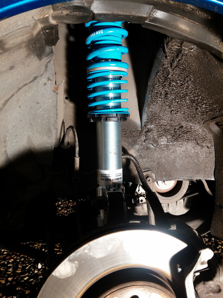

So I've been for a drive out to work in Leeds, then to Harrogate to see the woman then back again and I've concluded that they need setting up properly! That will be tomorrow night.

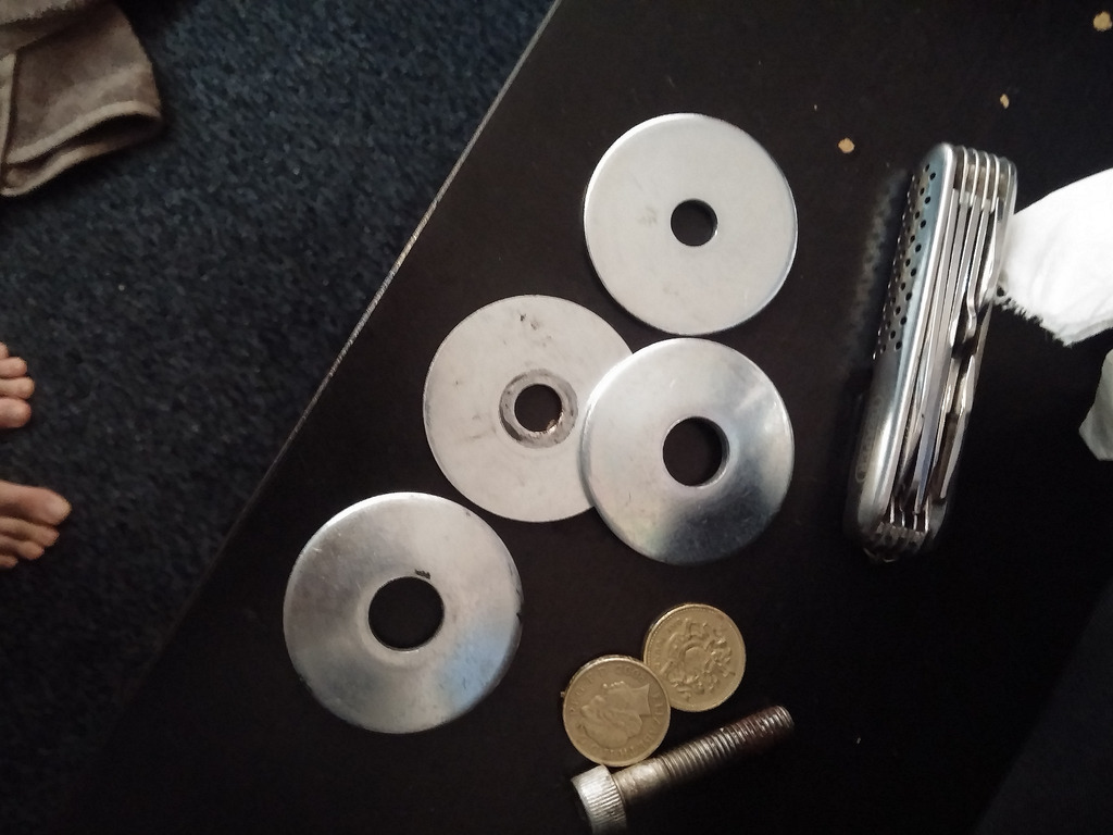

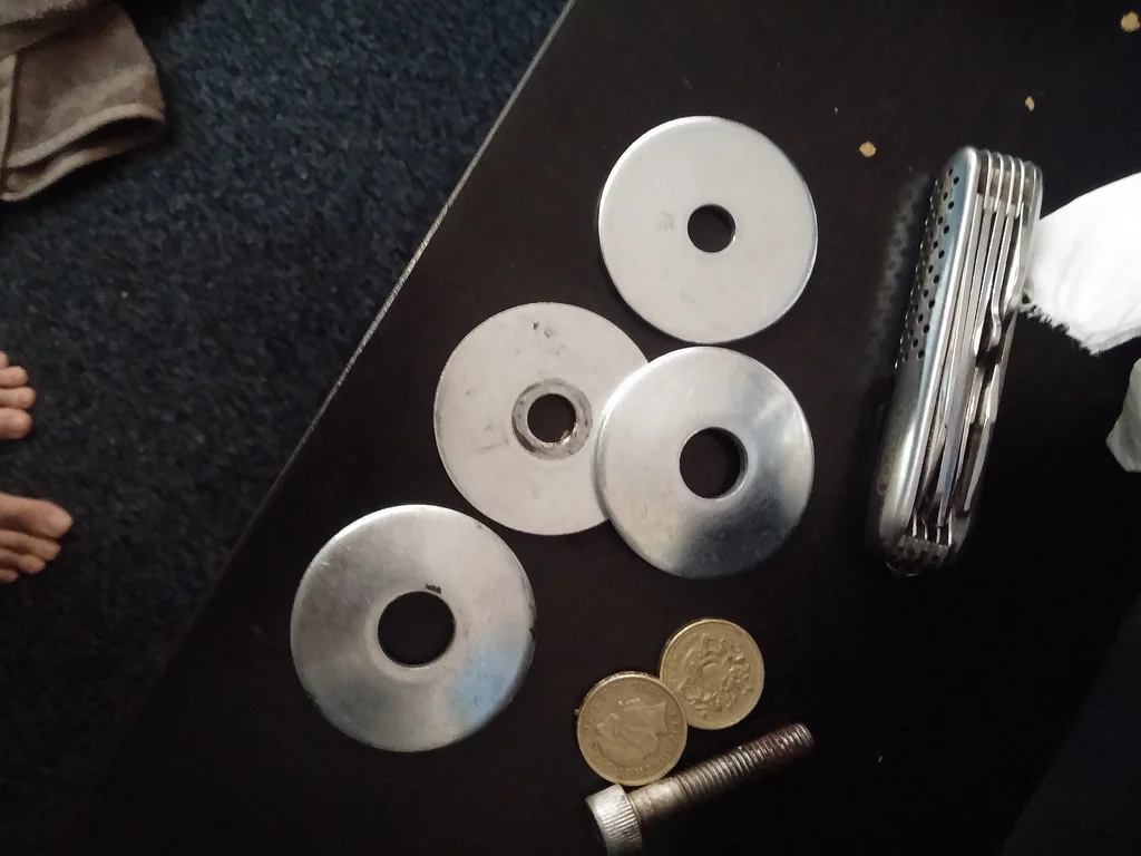

I knew they wouldn't be set up and especially without those washers on I haven't given it hell but it feels really twitching and unbalanced, obviously!! So tomorrow's job after work again (sigh), is to measure the cup distance as how @incy-spider suggested and get them equal as best as I can as remember last night in my hungry, tired, coffee fuelled state I span one of the cups to loosen the coil when I discovered the top mount bolts has broken to release some tension and mustn't have got it equal in comparison to the other one. I'll get them equal as best as I can tomorrow and fit those washers.
I didn't measure the diameter of the dampers, but the rear springs were just under 2inch (no idea why it's imperial measurements, I got it 48mm) and the front were 2 1/4 inch, so the dampers are obviously less than that

Anyway, just got in from the pissing rain (making the most of the new lamp haha) as i've levelled out the coilys at the front, they were 6mm different from each other. Levelled them and raised them for the clutch tomorrow as apparently they might get some issues getting it on the ramp with it being that low. Greased them to f**k too with copper grease.
Also fitted those rear washers thanks to @incy-spider for the tips.
