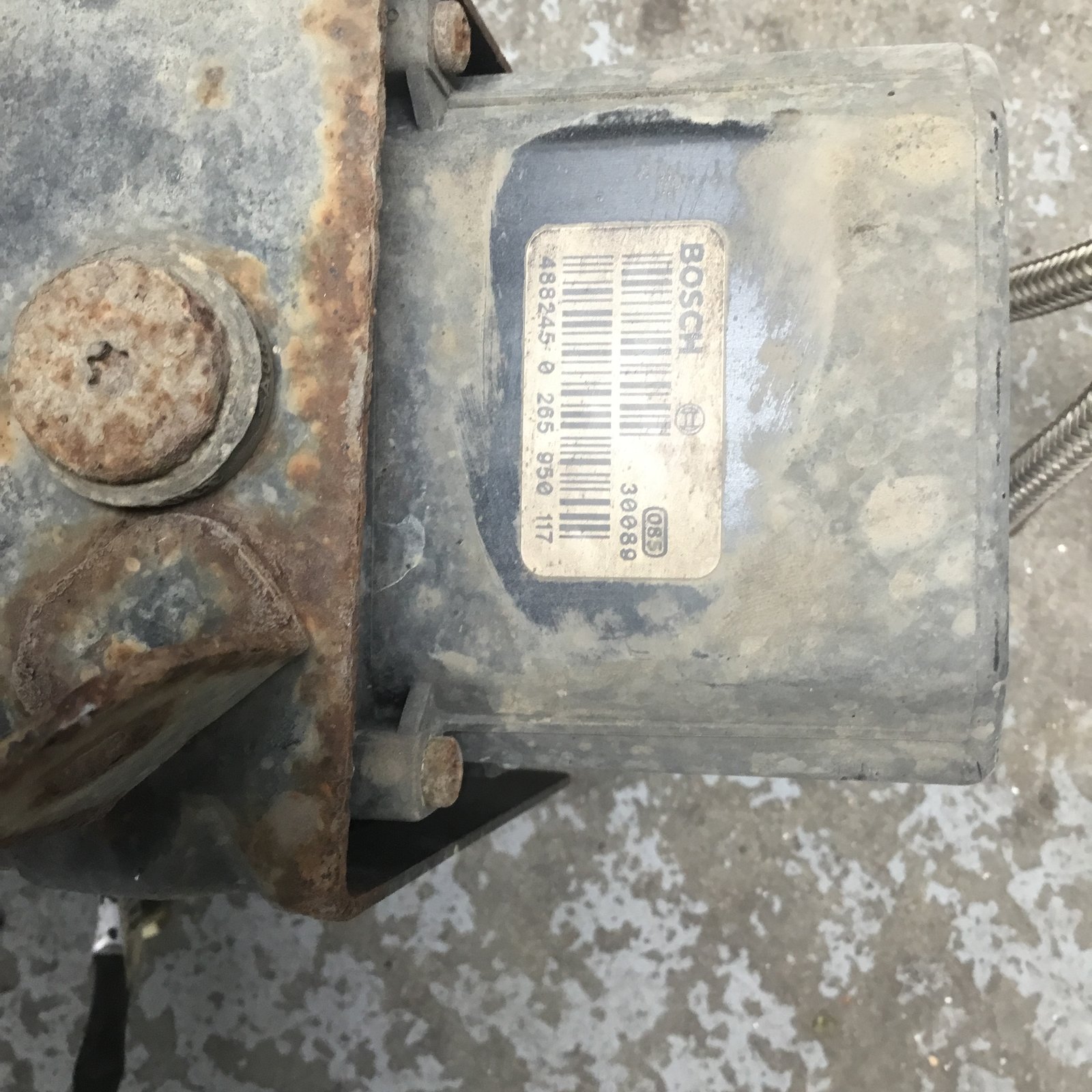

Its the code on top of the pump mate i have a 04 plate 182 that may match can you get a photo of the top of the pump?
I'll try my best to get a picture for you last time I checked the pump it was hidden basically under all the sound proofing stuff at the back of the engine and was difficult to see any of it, is there an easier way to see it or is that the only way from above ? If so I'll get stuck in and try and pull the sound proofing out the way enough to get a pic for you.

Great Bud thanks for that sounds fairly straight forward so I'll give it a go myself :up:
What code is it on the pump that's supposed to match ? Or does it not need to match and I've read something wrong 🙈 Haha.
