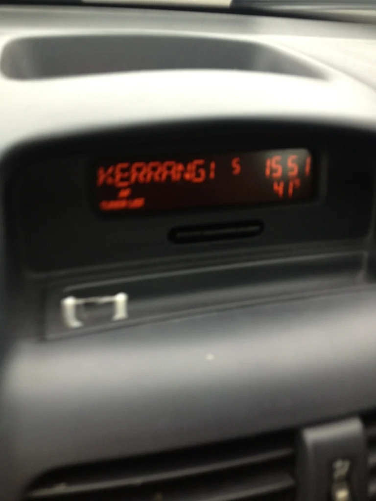

Is this possible a friend told me you can change this to say what you want somehow..
So where it says kerrang.. You can change that apparently..

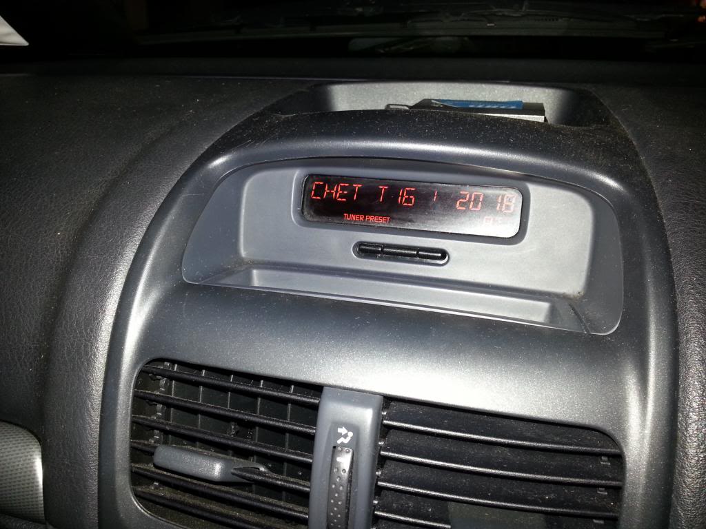

Getting somewhere useful now! Sorry for the crap sound, the heater blower is stuck on :rasp:

How have you done that? Tis awesome!

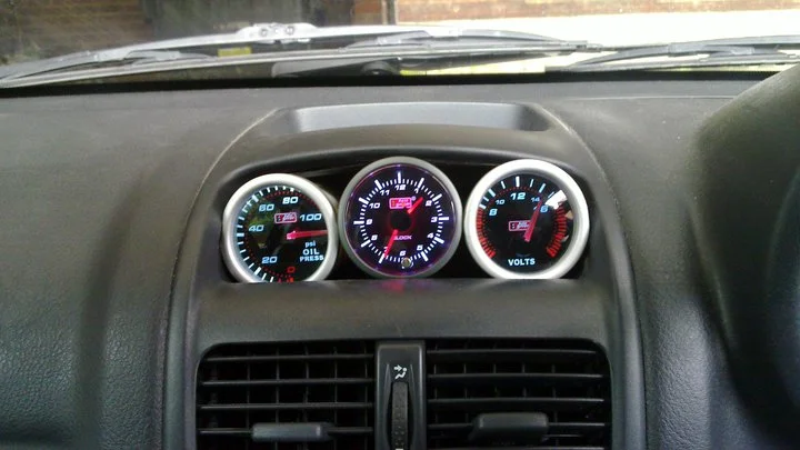

I have these instead a lcd now, did away with the digital display when i changed the HU
I need to re-seat them properly though.

I think I might be able to do that, I'll have to do some testing. I assume the standard radio isn't used?
I have a cheapie obd reader that's hacked about to connect to a microcontroller to read in the rpm value. The microcontroller connects directly to the connecter the radio uses and I've reverse engineered the protocol enough to get text to display

I've managed to read off a few values, I can't get oil temp I don't think.
I'm working reading the stalk commands so you could use them for control but I haven't got anywhere yet.
I have the standard radio so the most important thing for me is to keep that working along side this which is another thing I haven't figured out!
