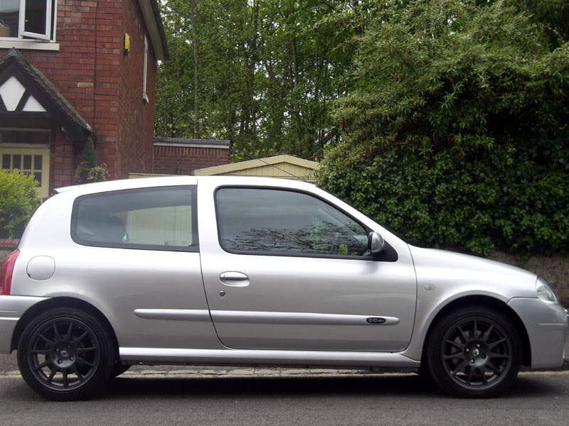

Tbh I'd say there is no change in the handling on the 16's. Got them on my Ph1 and the offset is different but haven't experienced any rubbing, even when dropped on 40mm Apex.
Mine below (on standard springs)
