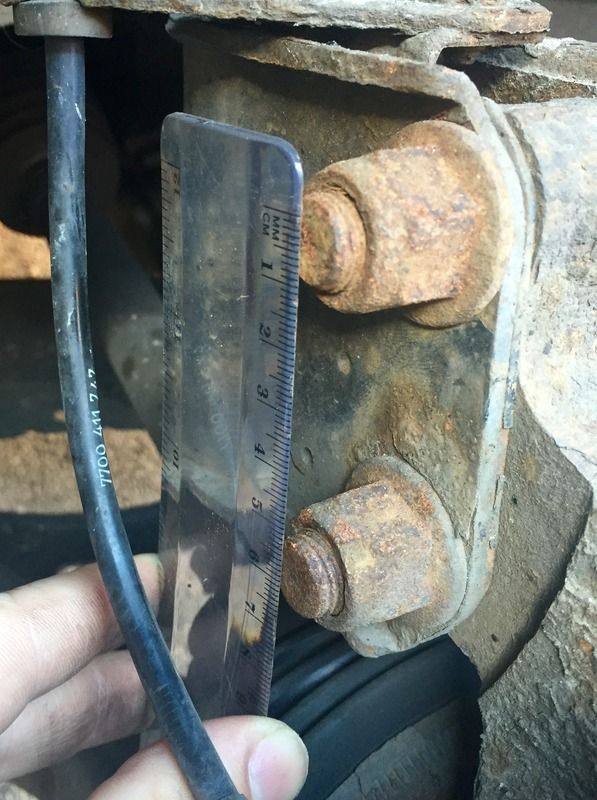

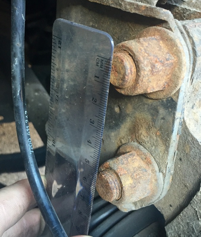

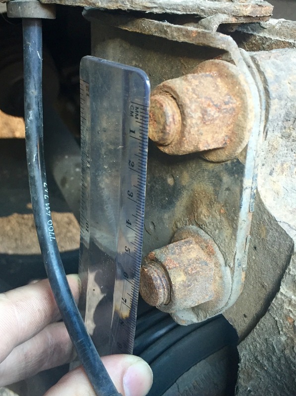

Before I potentially purchase some coilovers for the 182 can someone please have a look at these pictures.
I've done a search and have come to the conclusion that I have the cup suspension but just want to confirm.
Ps I hope these are the pictures of the right part!

You need to measure the centre to centre distance of the 2 bolts mate, but looking at your picture you have non cup packed suspension, so 54mm centres. This is the most common one for suspension options tbh.
The cup packed suspension would have 60mm spacing from centre to centre.

Nice one mate, cheers.
That seems to give better options for suspension. I'll double check tomorrow but that looks like 54mm to me.
