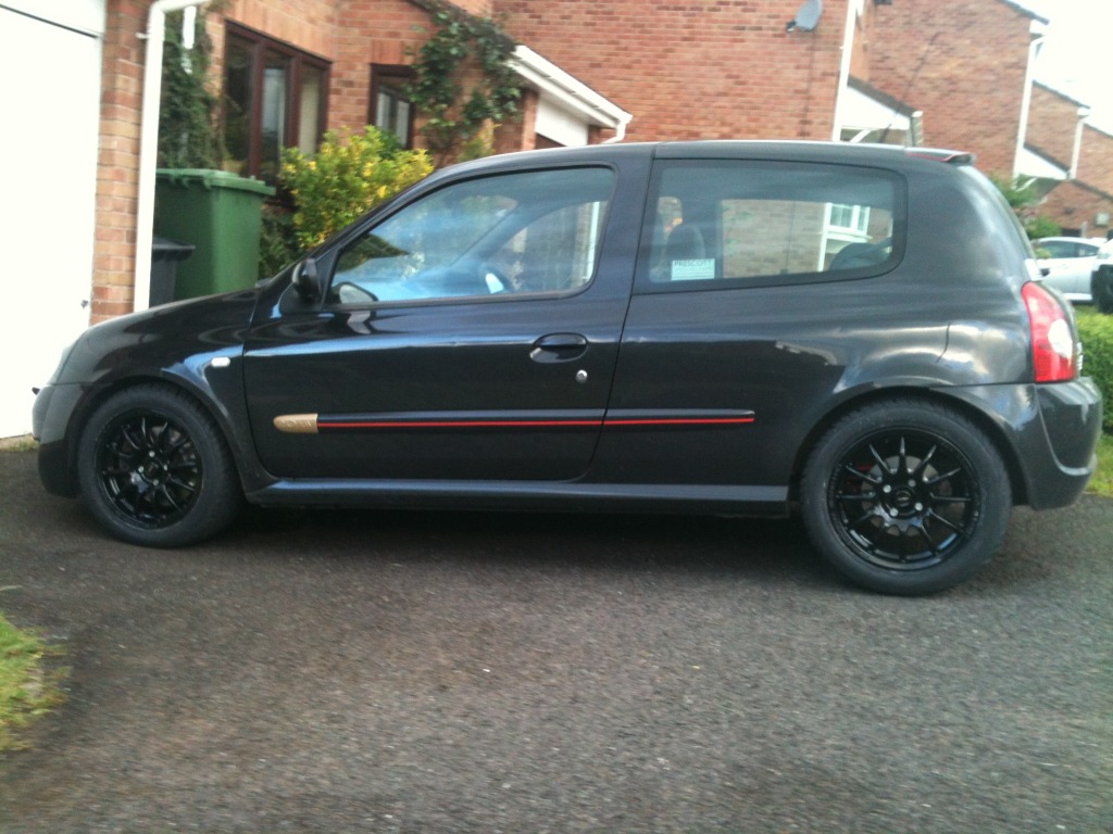

I got a non cup'd 172 and it's on 50mm lowering springs on the front.
To be fair the ride is horrendous, So I seen on here that cup suspension should be able to make the ride less bouncy and trashy.

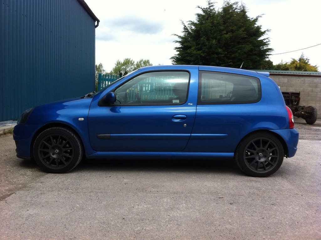

Prolines don't offer a drop, Sportlines will though. Mine's on Cup shocks and Sportlines. Excellent for road and track use. About 25mm drop though on average.
Untitled by Emma_Williams, on Flickr
​cup shocks and sportlines
