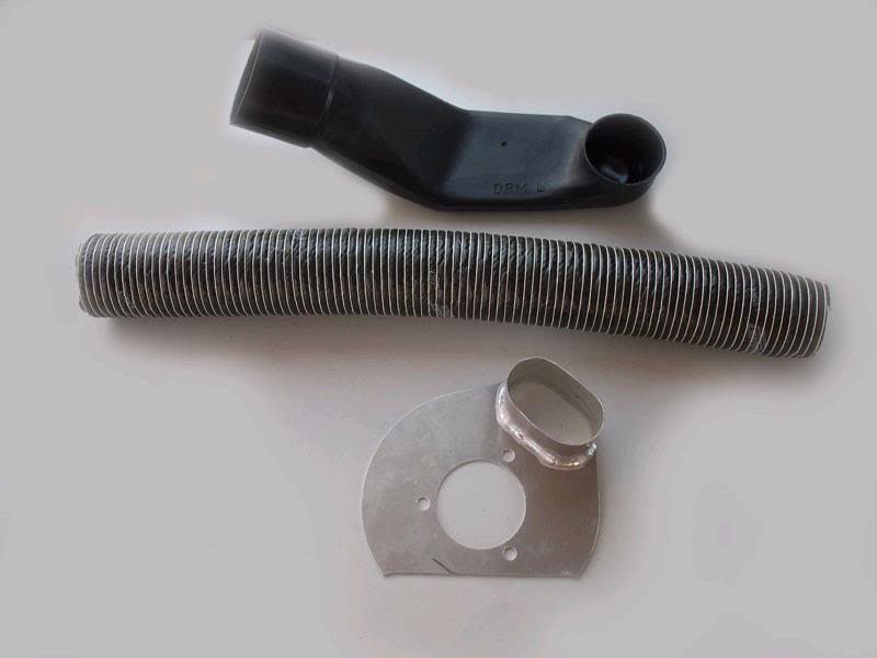

Cool cool, What I have in mind with regards to deflector plates is something like this:
I dont want to over engineer it too much tho.

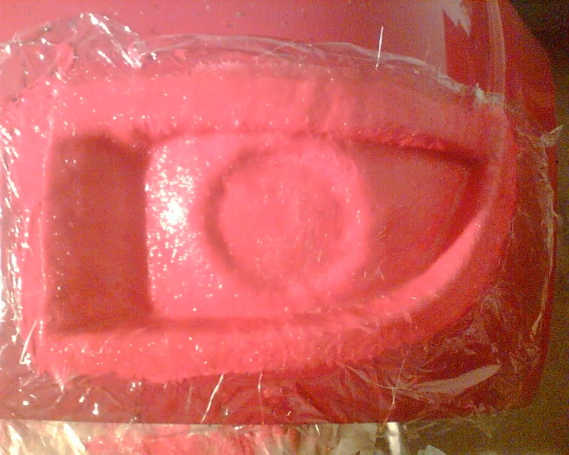

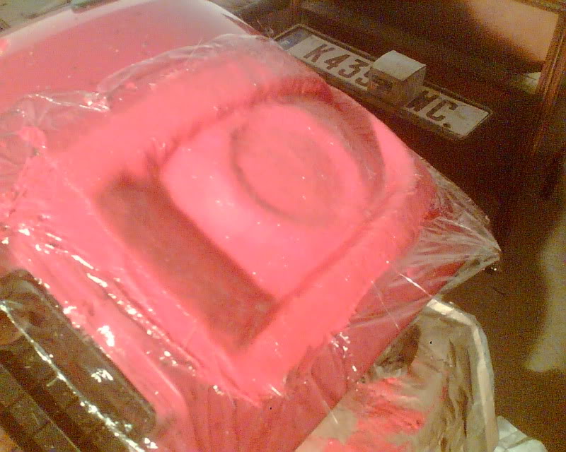

Right, a few quick photos of the design molds:
Took this mold to make sure the duct fits inside the fog light area perfectly. I will be making a reverse mold of this to give me my base from which I will build up the scoop and outer cup. Surface finish isnt important... hense the cling film.
more to follow :)

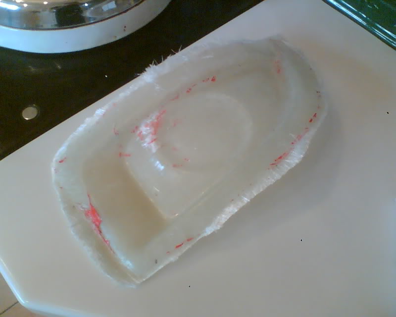

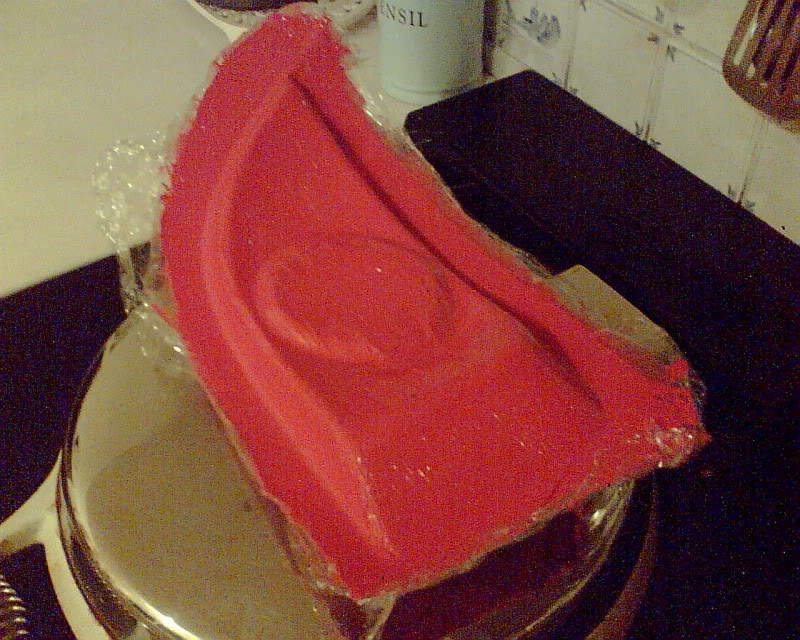

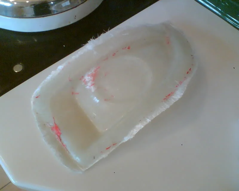

Only a quick update:
This will be the base of the duct (the part that fits in the oem fog light area) from this I will build up the rest of the part... I could have purchased some genuine ducts and modified them to fit then take the mold... but that would be too easy... cant beat building something from scratch!?
600gsm wet lay fibre glass (red parts are from the original mold gel coat...didnt cover it in enough release agent, wont be making that mistake again :)

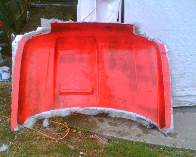

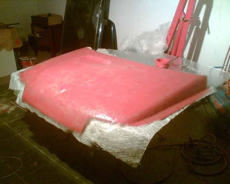

Mk2 FG bonnet... about £150.
Quick pic of the inner mold of the bonnet, was very quickly made and i'll only use it once as it was a one off.
