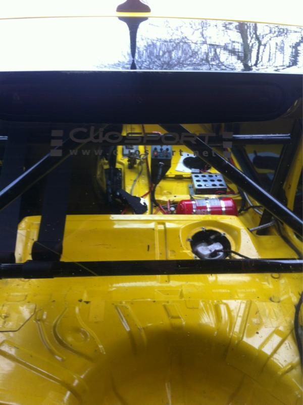

Does anyone know the route the ph2 cup racers ran their fuel line?
I have the full set up and would be good to run it the same route to ensure the hose reaches the pump.
Any help appreciated :)

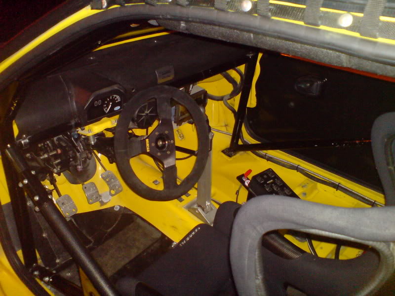

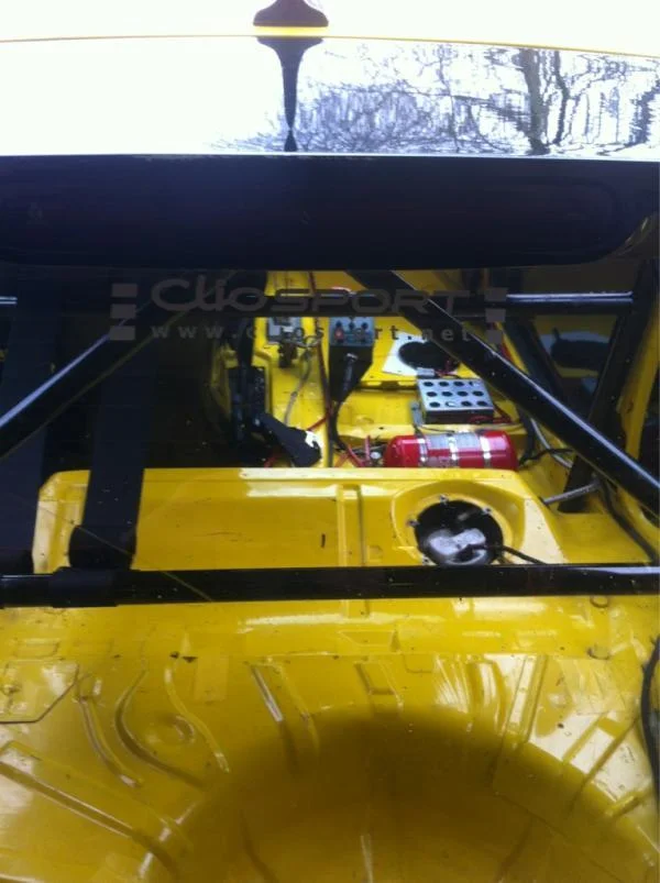

Hope these help, you can see it out the tank, along the side of the door and through bulk head into engine bay
