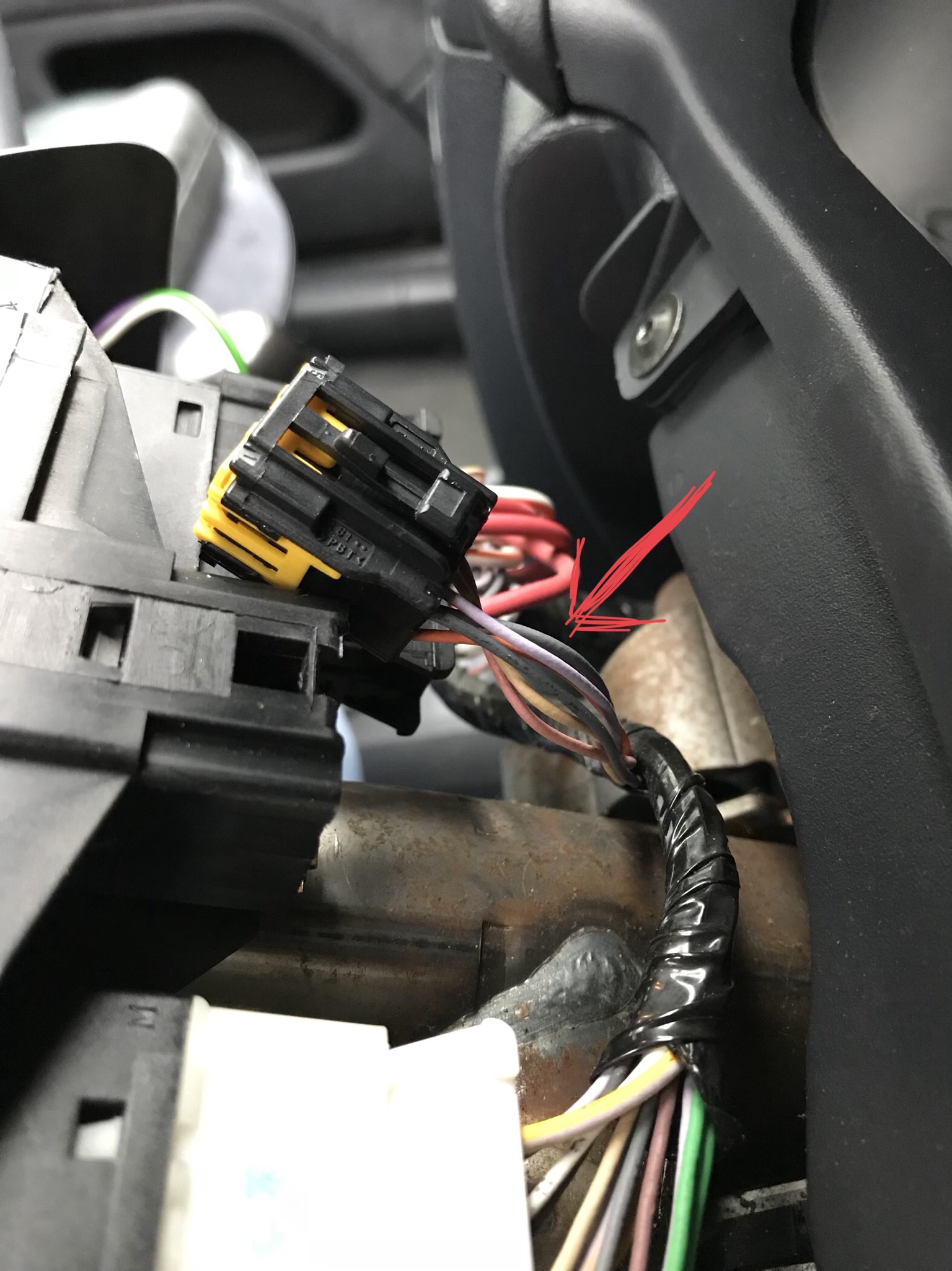

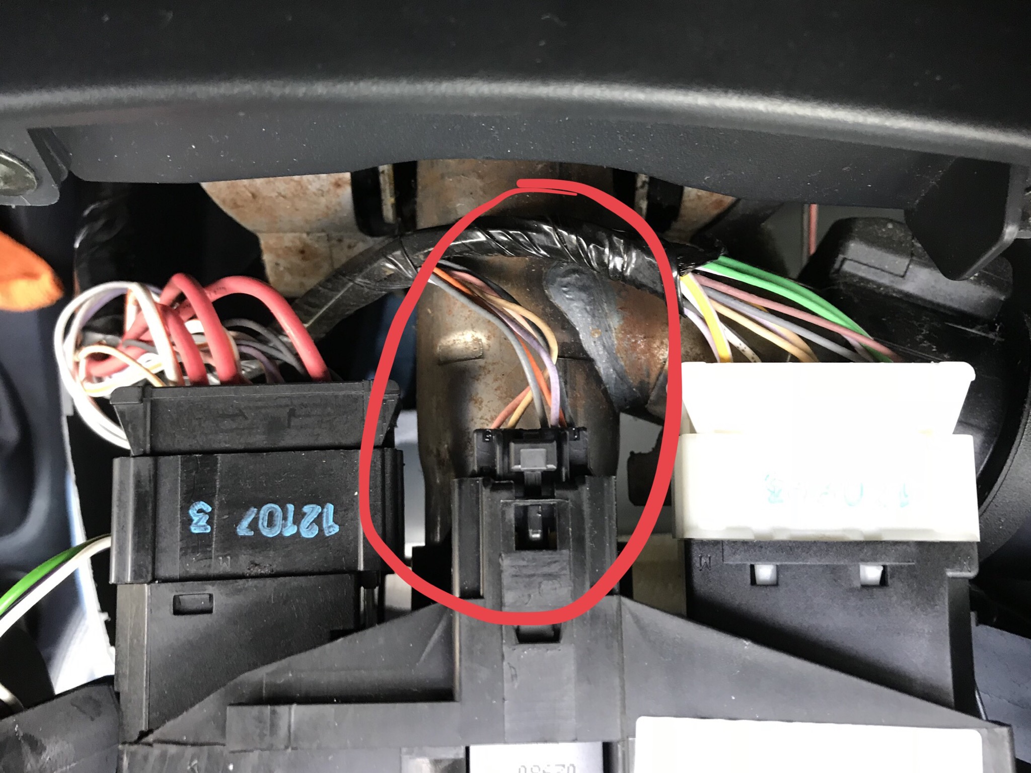

Just reviving this thread now I’ve made more progress.....I have everything sorted including clutch switch, replacement esp/cruise/limiter on/off panel, and I’ve got the dash is displaying cruise “set speed” etc.
I’ve wired up 4 buttons with the appropriate resistances to control speed +\-/resume/cancel - but now I just need to connect these up! They won’t be steering wheel mounted, so I don’t need a cruise control squib.
So somewhere behind the squib should be a loom with the two cruise control wires. Any idea what colour the two wires I’m looking for are, and if they are bundled together on another connector? Any help greatly appreciated :up:.
oreA
  BMW M135i; Clio 172
For anyone who’s interested (apart from me :grinning:), the two cruise wires from the ecu terminate at the same plug as the steering wheel airbag wires. So I tapped into these (purple and black) and have successfully got cruise working without changing the squib :up::cool:.
