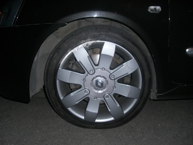

Just hit a curb that was sticking out in the road (if that makes sense...) and to make it worse on the way back from the airport... I was amazed the aribag went of (20mph..) but it had a sharp edge that ripped sidewall and chipped alloy on front and i reckon the I drove over the chip that gave the rear a flat...
Thye upshot is i need a 182 cup anthracite wheel asap as i need to get new tyres fitted to get back on the road... does anyone know where i can get one delivered within 24-28 hrs to the london area that is fairly reasonable?
Ive been surfing the net looking but cant seem to find much at all... any help would be greatly appreciated... the AA are just charged £95 to tow so I will get the alloy delivered and then get mobile tyre fitters.... the ironic thing is all four were new about 100 miles ago...​
