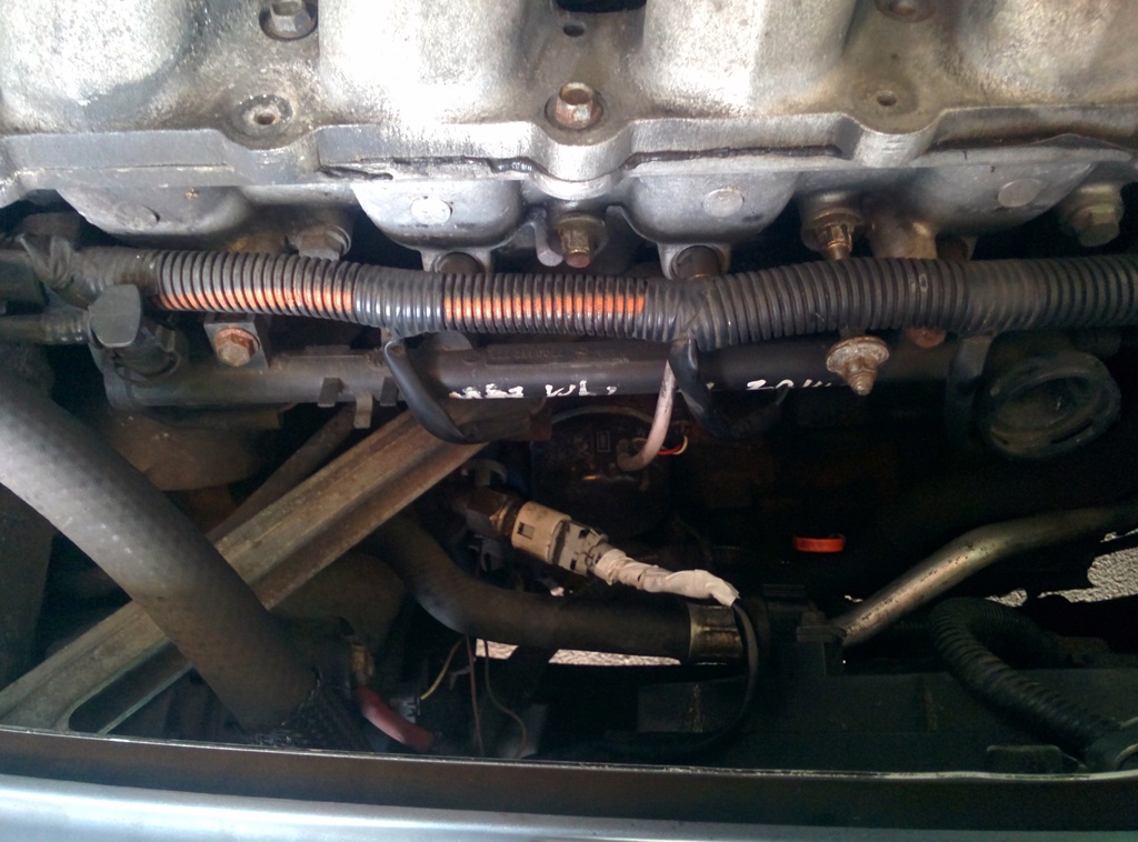

  2003 172
Right, another update.
I cleaned all the connections I could find, took the pedal off, opened it up and cleaned it, then did the same with the throttle body. I couldn't find anything wrong with these.
Then I saw a connector at the front of the engine- the wiring had been badly repaired before and two of the wires were touching. I stripped the wires back and put a load of insulating tape around them(White tape in the pic).
So far the engine is running much better- it started first time this morning(instead of starting and then cutting out) and was nowhere near as rouigh during the 1st 2 mins(whilst the car is in the cold map).
The emissions light is still on- 20 mins with the battery disconnected didn't clear this, but i've heard it goes off after about 150 miles or so? I'll wait a few days and see if this happens.
  02 Iceberg 172
That's the power steering pressure switch iirc. Not sure if that would be what was causing your issue though? I had a similar issue to what you describe and after cleaning throttle body/pedal connectors, fuse box, relays, ecu pins etc haven't had it come back since.
