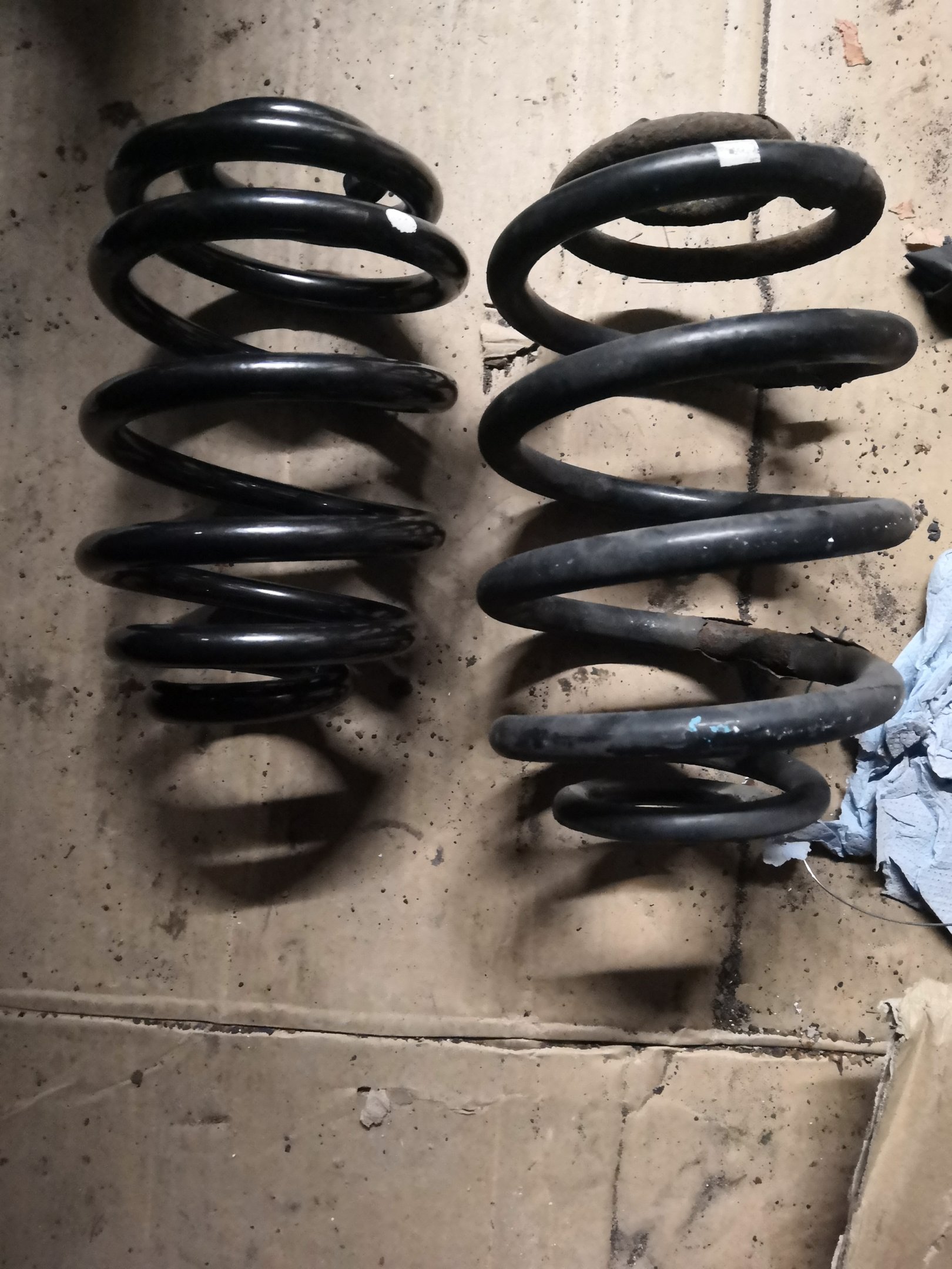

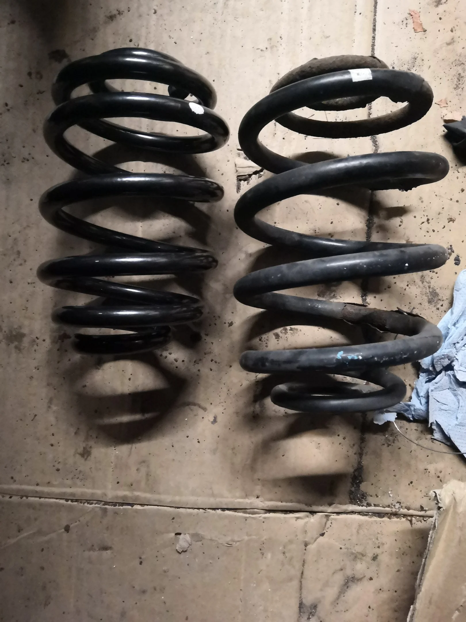

Hi all, I've come to fit my cooksport springs, did the fronts I think there OK, moved onto the rear. Unfastened the shock lower bolt to take out old spring. Put new cooksport spring in. Fastened bolt and to my surprise the cooksport spring is really loose. To the point where is there is no weight on the rear they could fall out. This seems wrong to me? Pic of old spring and new spring. New one is much smaller in height. I get that it's a lowering spring but I thought that was down to spring tension.

Have you got the rubber on the springs? That usually helps them stay in place.

You got the rubber spring cup things?
They're obviously looser but won't fall out once back on its wheels.

Eibachs were very similar when I fitted them, without any weight pushing down on them, you could easily pull them out - they were ok once the car was lowered back down though

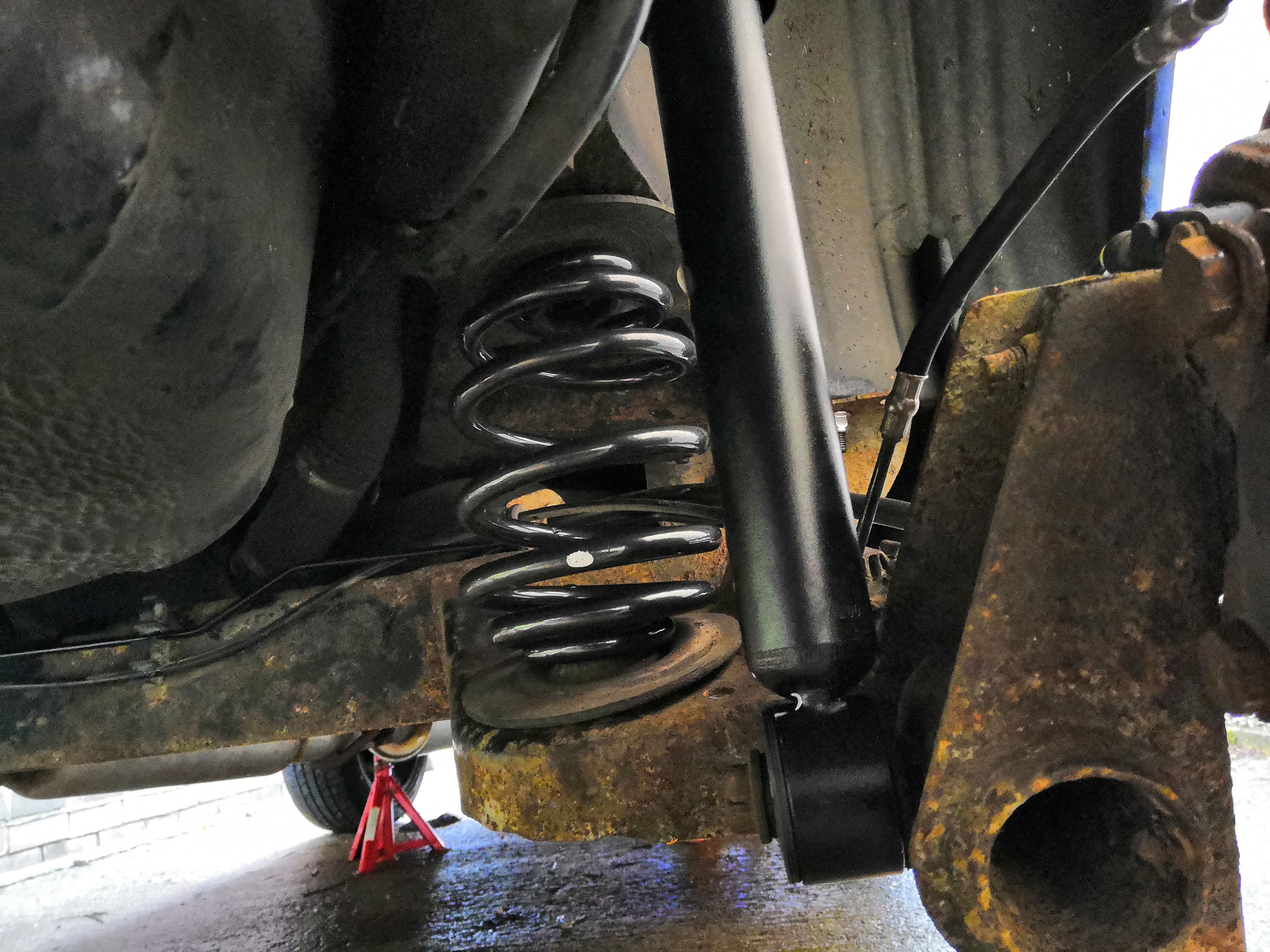

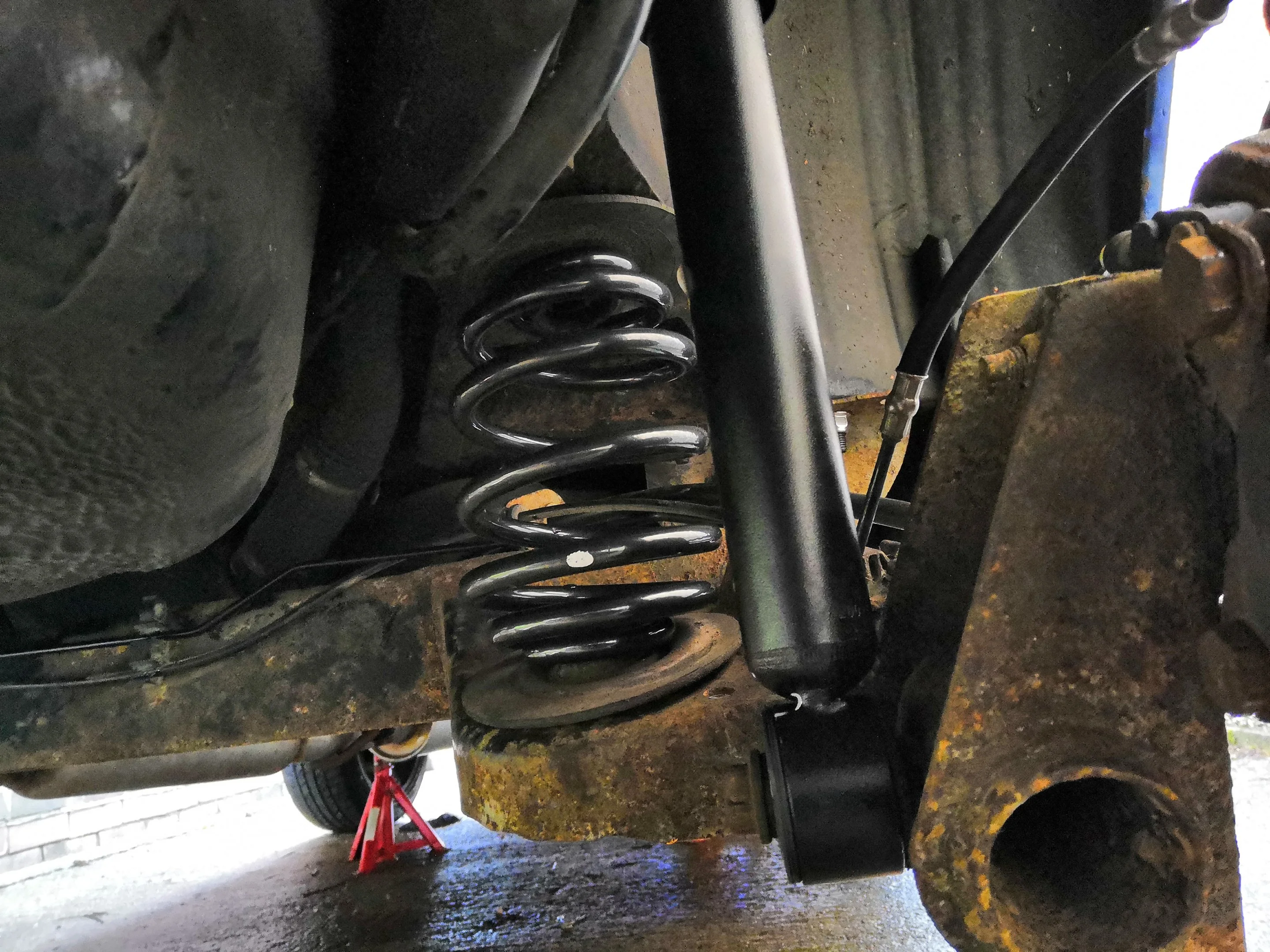

They're are so lose that they could very easily come out. They don't touch the bottom of the car in anyway

They can torque up but not be all the way in.
Just looks out to me a little bit, id be removing and redoing imho. Always run a tap down those threads when doing my rear shocks

They are flush against the shock flange. Looks out cos the shock is black and the. Picture dark
