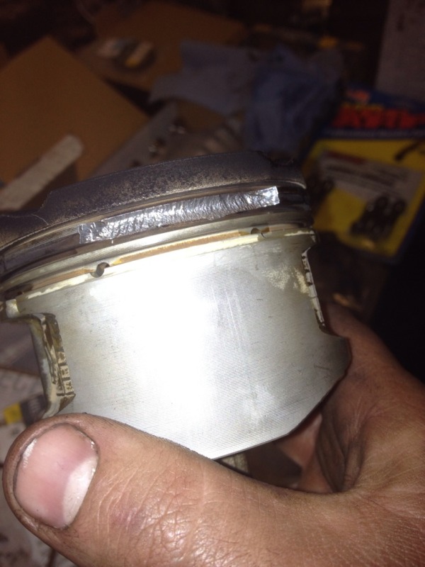

Not that I want to s**t the wind up you but this was making 165psi!
