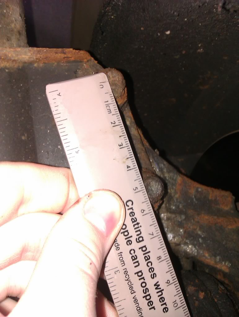

Could anyone tell me which coilovers would fit my car, unsure on the bolt spacing and wouldn't have a clue on how to measure it.

Should be 58mm on your car. It's the distance between the two bolts connecting the strut and hub on the front. Can be measured with wheels on full lock.
I think the ph1 may be 52mm.
Measure them like this (from centre to centre of each bolt)
(mines 52mm)
