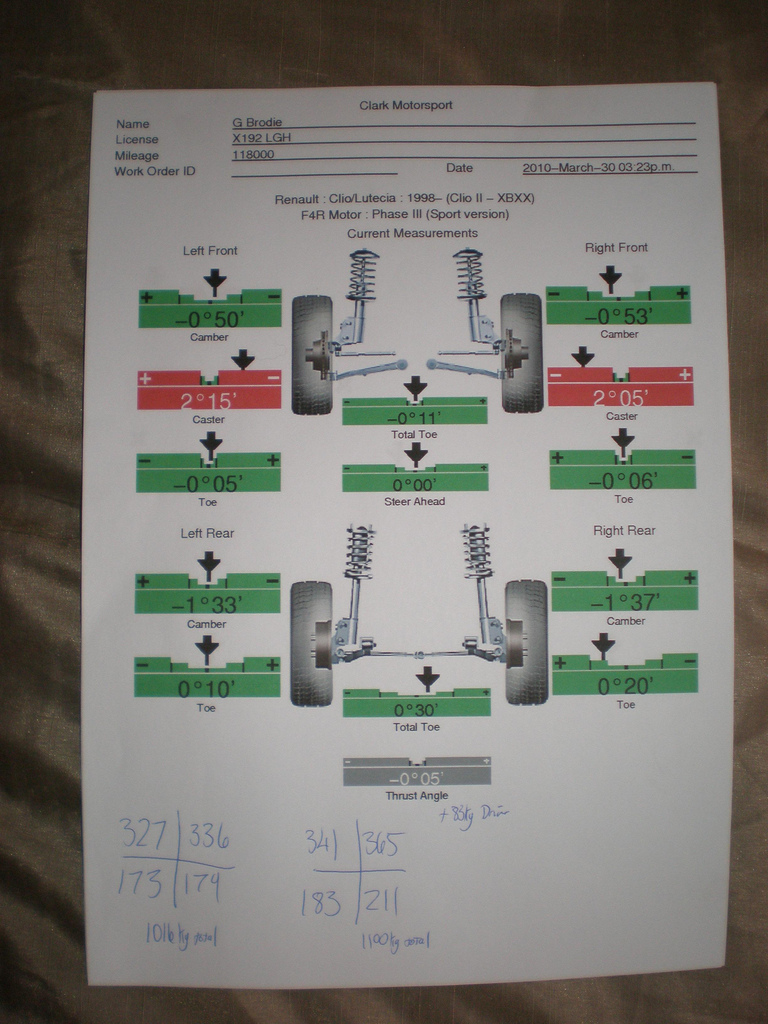

Well i went for the D2's and they seem fine but the slow corner undertseer is still very much there. I contacted D2 and have been told the spring ratings are 419lbs at the front and 224lbs at the Back so i'm a bit concerned should this not be a little harder?.
I have an ARB coming soon so maybe it will be fine just by fitting this?
Any comments guys?.
heres the geo stats at the moment.

Yeah i'm trying to find camber bolts to get more camber any suggestions?.
I was also told that if i switch to AVon ACB's as i'm thinking about doing then i don't need more camber is this correct?
